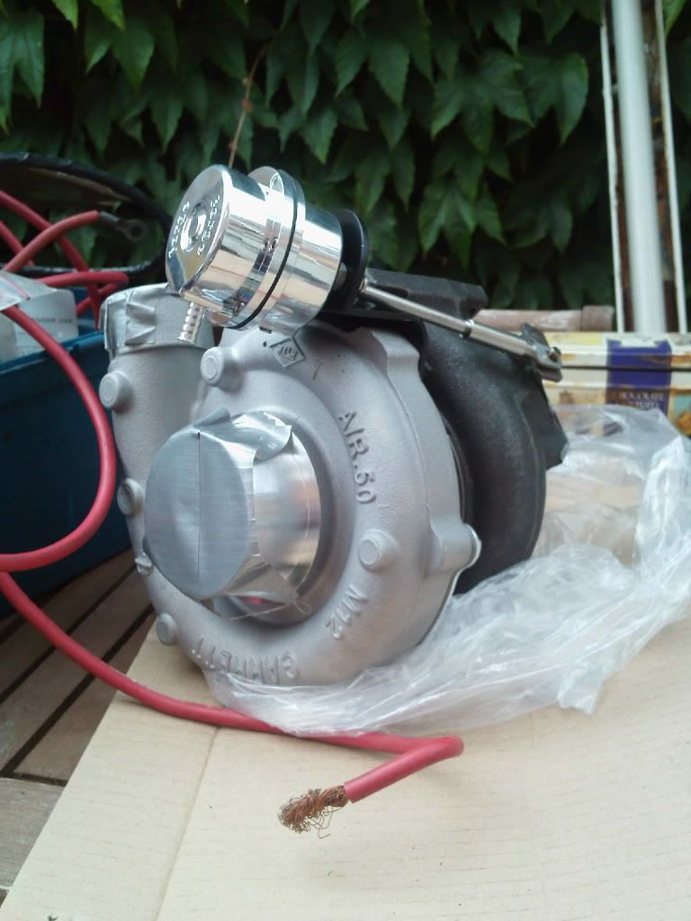

Couple of pics to help anyone searching similar stuff in the future.
Ok, I have just tested an old turbo actuator by connecting my foot pump to it and watching what happens as I pump it.At around 10ish psi the actuator opens the wastegate.It stays open and the pressure holds inside the actuator until I open the valve on the pump.
When I did the same to the forge one, I held my hand against the rod to feel if it moved and it doesn't.It also doesn't hold the pressure inside the actuator it leaks out losing 30psi in about 2 seconds.I am thinking that it could be the diaphragm is damaged so cannot overcome the spring pressure and open the wastegate.
Thoughts appreciated.
Sounds like a reasonable assumption to me; that or it's not sealed around the edge (so air is escaping past it). - How old is it? I'm pretty sure it's easy to get hold of replacement diaphragms, but if it's new I wouldn't have thought it would be split so soon.
There are a few people who've had a problem like this with the forge actuators aren't there?
No, have emailed forge asking about it, I imagine they'll send me a replacement diaphragm and if I am lucky I will be able to replace it in situ as the access is from the top.
Edit:had a look and you can' take the top off in situ as one of the grub screws is obscured by the gearbox.
Dropped off car closing time saturday and spoke to garage today, the diaphragm had ripped like I though.I asked them to remove the 2 spacer nuts I had used on the actuator if possible so if it happens again I can maybe take the top off with it still on the turbo(Perrin21 said Spikey could get to his on standard turbo) but they tried and came to same conclusion I did when fitting it that couldn't get enough tension on the rod without them.A bit more thread on the rod would have done it though.Should get it back tomorrow morning and then just a bit of messing with some things and will be ready for remap on wednesday.
