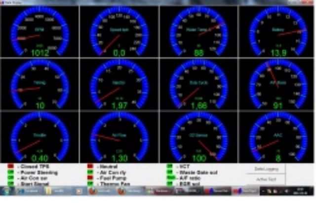

hi,
i did a fault check and i get nothing (no fault) my AFR is running 12 at idle, when cruising i can get 14.5 but i the second i hit 1 psi of boost (even at 3000 rpm) i get 11.0-10.0 AFR.
here's my reading at idle.
I also have a short log file
during the log i get at the first psi of boost 11.5, 11.0 then 10.5 AFR
