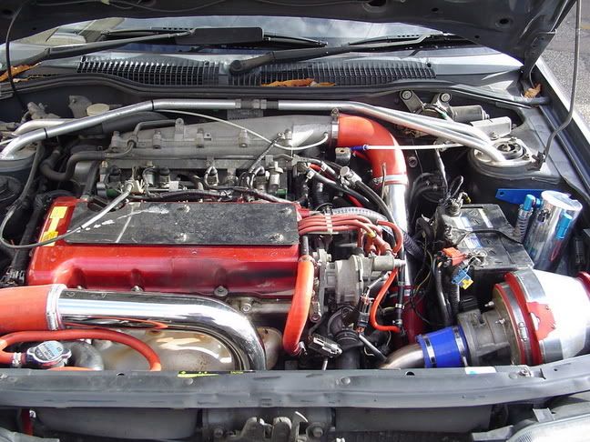

this is mine the catch tank is/was connected to the inlet,some peeps will disagree, but there is a reason why all manu use vaccum to suck out the fumes from the sump as it can cause problems and power consumption etc
