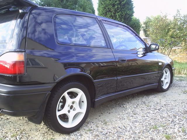

ladies and gentlemen i give you.....my funny caR:doh:
funny thing is iv already fitted the springs the other way around as the shorter springs were actually slightly thicker which logically ( hahahaa:( ) suggested they go to the front, result? the rear sat lower than the front:doh: after a lengthy search i found it repeatably mentioned that the taller springs go to the front and this is how its ended up.
the gabs came off an R which as far as i can remember sat fine:? its just the springs that are different:? :? super helpful demon tweeks wont even bother looking till iv got the serial numbers of the springs:( iv spoke to a guy at whiteline who confirmed that the car would sit slightly higher at the back but not the 60mm iv measured......
i just knew i should have just bought some teins:der: :x :roll:
That looks bl00dy stupid :shock: :doh: .
You should fit some cusco top mount on the front that would bring it back up to the right hight I'm sure ;-) .
Dooie Pop Pop
read the edit above Rob the taller springs are fitted to the front......... "remembers back to your top mounts":lol:
does the front look ok? it feels better than it did with the other springs on the front. would dropping the rear down raise the front the 15mm its missing??

THanks for the photo, it made my day :)
I did some calcs in my head on the drive home from work and given the standard measurements are 365 and 375. Given whiteline drop it about 40mm and they will use a rate similar to Nismo of 4kg/mm front and 3 kg/mm rear. If you had a 3kg spting on the front and 4 kg on the rear. You'd roughly get a 70mm drop front and a 20 mm drop rear.... ringing any bells?
Could you have put the front springs on the rear struts? The strut lengths are different IIRC which might account for the difference you see when you swap the struts. Failing that it can only be the wrong spring rate length/rate.
To check your spring rate, you should find the front really soft and the back quite taut if they're wrong. If they're right then more or less they will feel the same.
