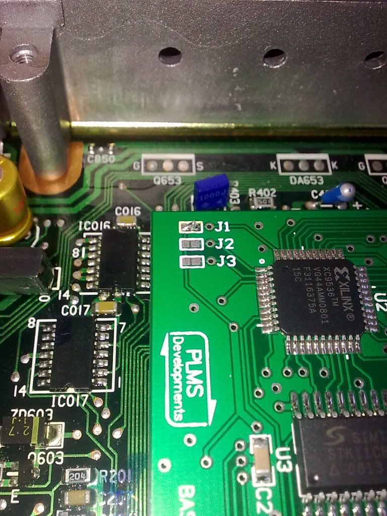

I took a picture of the jumpers from the Nistune daughter board.
Is this correct ???
Jumper No. J1 is locked and jumper No. J4 is unlocked
Fusion Ed
Its a bit dry but should work. The fact that you can connect the software too it says to me its fine. I need a data log you need to get one of the car NOT running and send it to me. You may have a sensor problem.
