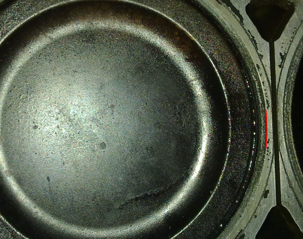

I decided to remove head and check the gasket. Cylinder 1 was dry, No2 was a little wet, No3 had oil, and No4 was like No2. Gasket was not in a good state either. See pics below
