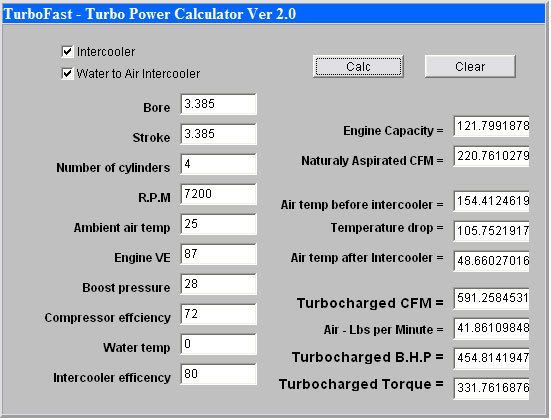

there is an estimate turbo calc online
http://www.turbofast.com.au/tfcalc.html
I played around with the figures using water/air setup and the difference was 15bhp between a having water running in the system at ambient temp Vs water running in the system at 0C.
These calc do not reflect real life figures but they do have a small bearing to calculate approx figures.
