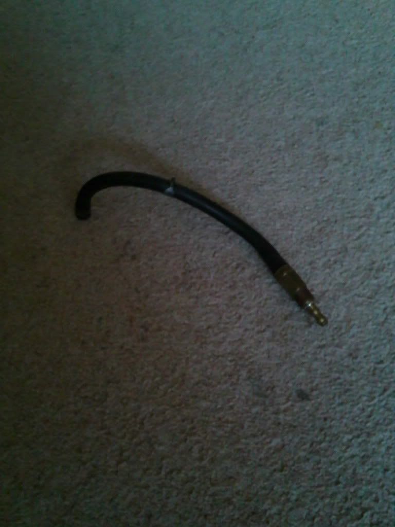

Most people would have to take the turbo off to do it, so easier to fit something like this:
Its a Dawes type device which is just a posh bleed valve that will let you control the boost.

sorry but a bleed valve shouldn't go anywhere near a GTiR (or any other car for that matter....except for Fords cos Ford owners are wankers)
and a dawes device is anything but a posh bleed valve (but i know what you meant)
I would sooner have a dawes than one of the usual electronic boost controllers that's usually fitted.
I quite agree. I had an EVC III which went in the bin in favour of a dawes device... admittedly the solenoid had gone on the EVC, but for the sake of an overboost alarm and some glowing lights it wasn't really doing anything useful. - As you say, set-and-forget. I'll control the boost whilst cruising with my right foot.
