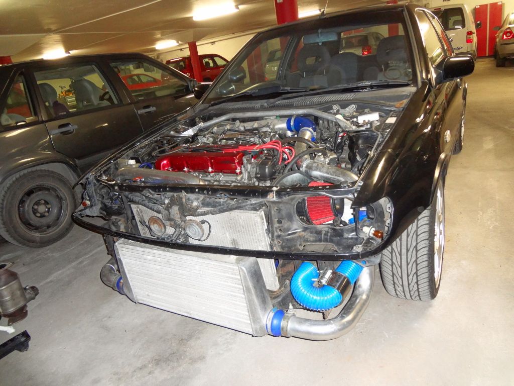

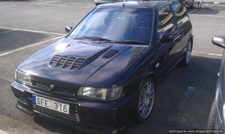

Ill get some better qualitypics up within a week or two. The fronts at the paint-shop as it was starting to look shoddy and the bonnets just had a rust-patch removed. I put the original grill back on as I think its nicer than the kudos one.
