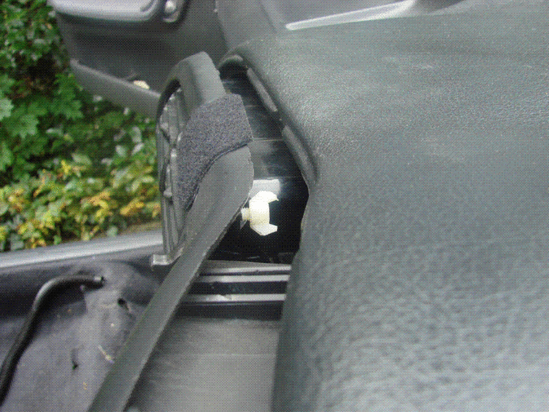

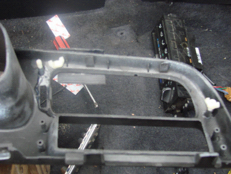

Modded the centre vent attachment screws (normally a right pain in the **** to undo and replace) to M6 nylon studs and cut down nylon wing nuts.

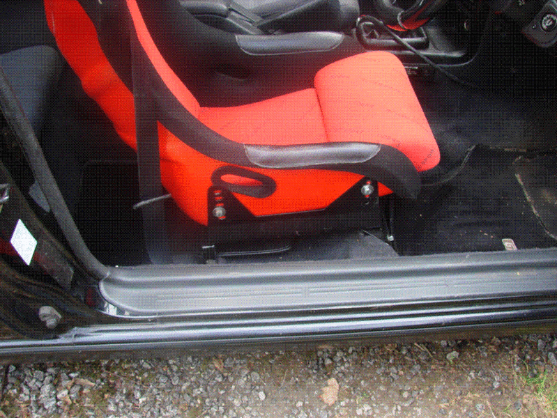

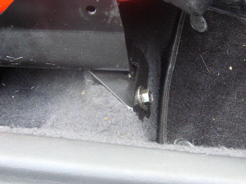

Fabbed new drivers seat rails to fit Cobra Suzuka Kevlar seat (ebay bargain), actually managed to get seating position 40mm lower than standard.

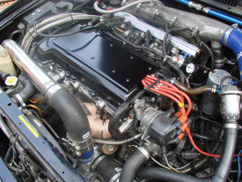

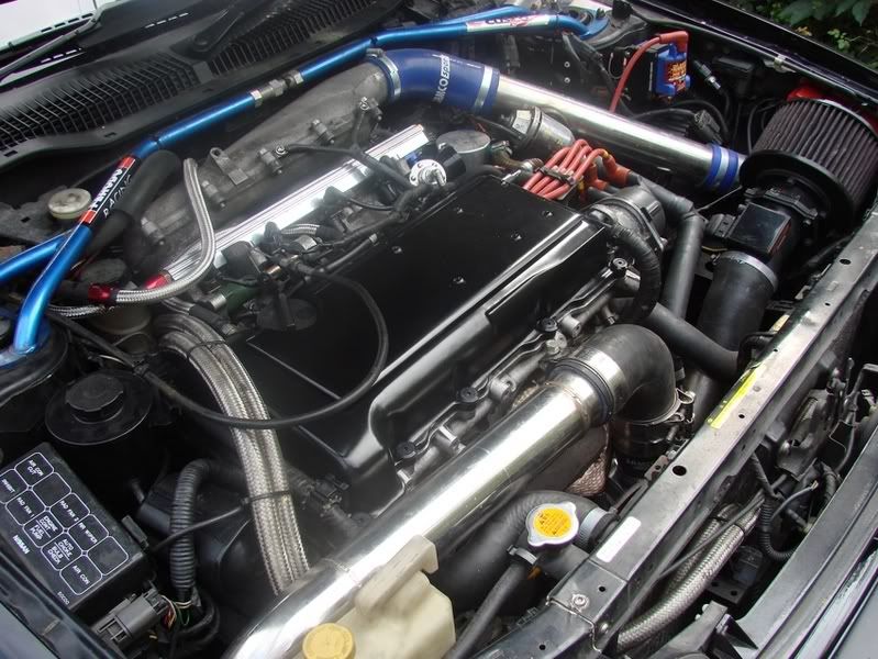

Fitted new powder coated black rocker cover.

I must admit I have always had my suspicions/reservations of fitting a bucket/race seat but I must say that now I have a much lower than standard seating position and am firmly fixed in the seat it inspires loads more driving confidence and allows much more driving control.

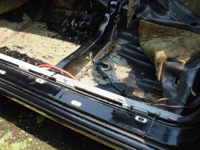

before I ripped the whole interior out and discovered that both rear footwells were rotten :? , I'd just chipped off the tar from passenger side

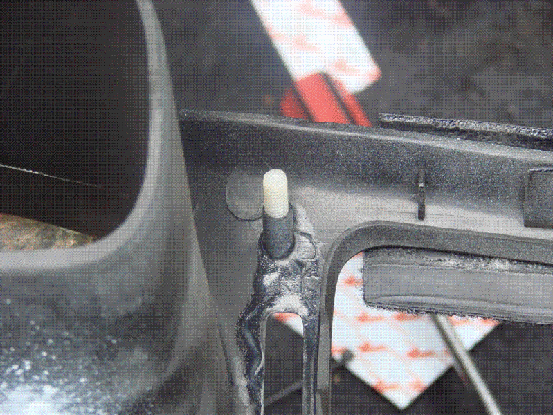

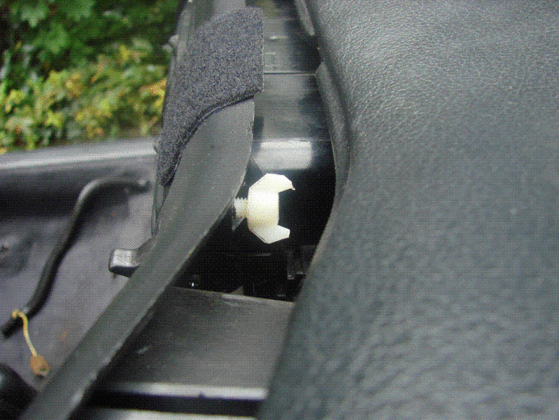

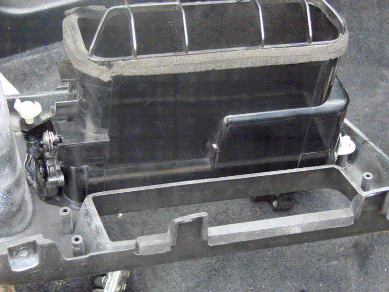

Few pics of the new M6 Nylon studs fitted to rear of centre vents (basically, I drilled the original self tapper hole to M5 then tapped a new M6 thread and fitted the stud with a drop of Loctite). As you can imagine the chopped off wing nuts are so much easier to tighten as you can use fingers and don't have to **** around with a screwdriver that doesn't fit.

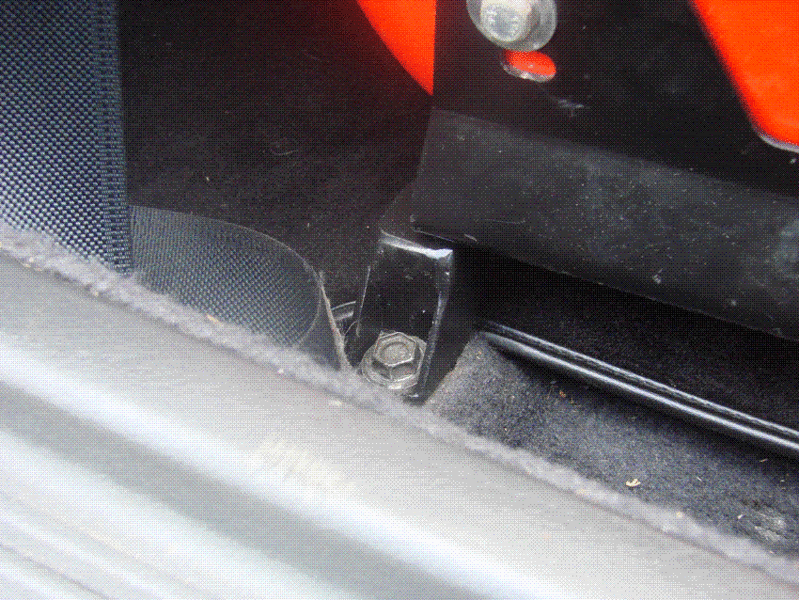

Heres a few shots of (all you can see) the seat mounts I fabricated, very pleased with how these turned out as the seating position is lower than standard.
heres a couple of shots of the new powder coated rocker cover fitted
Dooie Pop Pop
the rocker cover looks mint Steve;)
hows your manifold getting on with the lagging? has it been on long or cracked at all yet?
Keira
its a cast standard manifold by the looks of things stu, its got as much chance of cracking as you have of actually getting your car back on the road without something else going wrong :lol:
Dooie Pop Pop
ow:cry: im telling my mum :lol:
yeah standard thats what i thought;-) i didn' t know how they take to lagging... so i asked:lol:

why **** about with the wingnuts when all you need to do to remove that part of the dash is to unclip the cable (that runs from those vents) by the drivers footwell.
Yeah, I knew that :oops: no one likes a smart **** :roll:
I'm not sure the lagging does much tbh Stu but it was all a bit tight so I put the wrap on the pipe just to stop things touching. It was only supposed to be a temp measure (yeah right) as I planned to make up my own standard position tubular manifold. I might get round to it at some stage :lol: :lol:
