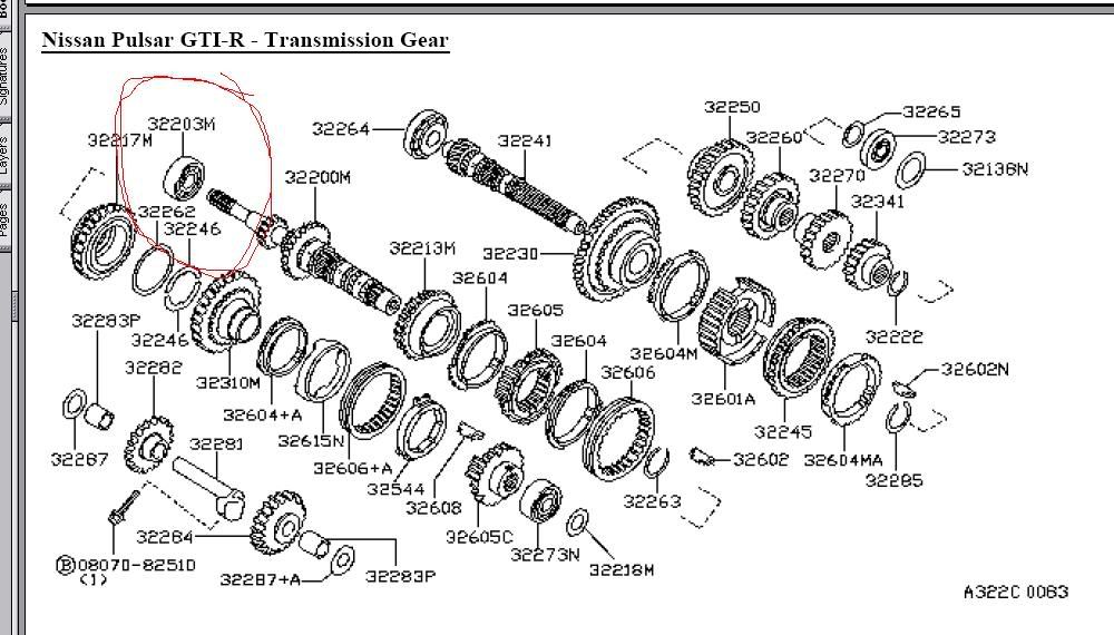

Just need confirmation or correction that this is the Input Shaft Bearing (circled in red).
Thanks
hmmm
Can someone confirm or correct that the item circled in red is the Input Shaft Bearing please.
Thanks
AVOGTIR
that is the bearing
part no 32203-03E10-
but it is cheaper to go to a bearing supplier/wholesaler to get them, as they are about 1/4 of the price.
