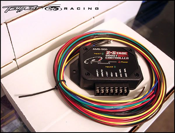

Just get one of these....
two stages of boost (three if you turn it off, it then relys on the actuator), dead easy to setup (you just dial-in your PSI, no messing with gain, percentages etc etc) and only 400 dollars.
That's about $350 more than I've got to play with at the moment.
Still, you're quite right; that's all I need.
