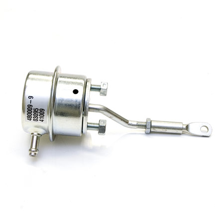

sorry bout the thread Shane the turbo' s a good choice but i do seriously think its about a big as you can go with an internal gate, you may get creep problems you may not. appently derestricting the turbo by using a 3inch exhaust makes it worse. not that i mind 1.4bar by 3500rpm :wink:
iv also found that i have an .8 actuator fitted not the 1bar jobby i thought it had, this is going to limit the amount of boost i can run a little but i kinda look on that as a blessing in disguise :)

GT3071R-WG does it have to have an external wastegate as ATP says it does :?:
Also what is the actuator :?: They say I have to but this seperate :?

I would get it from Turbo Technics mate as they can/will supply the turbo as a direct fit for your car without any messing about with the actuator etc. It might cost you more but worth it in the long run as its a supplier in this country and is a direct fit with no worries.
And just to clear it up, atp obviously don't know what the're selling. Just ask them to take a look at their homepage
"3071R-WG, THE INTERNALLY WASTEGATED TURBO" :roll: :lol: :lol:

speak to Ashills he can get a direct fit turbo from turbodynamics complete with actuator and bracket ready to go. thats where mine came from :wink:
