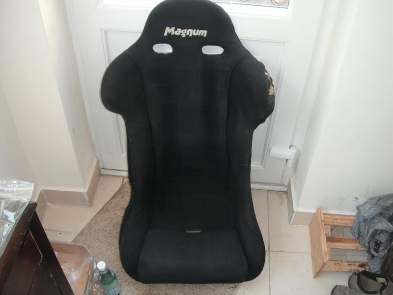

Here are some pictures; as I say it is a bit tatty:

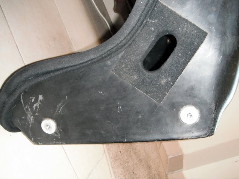

Side mounts...

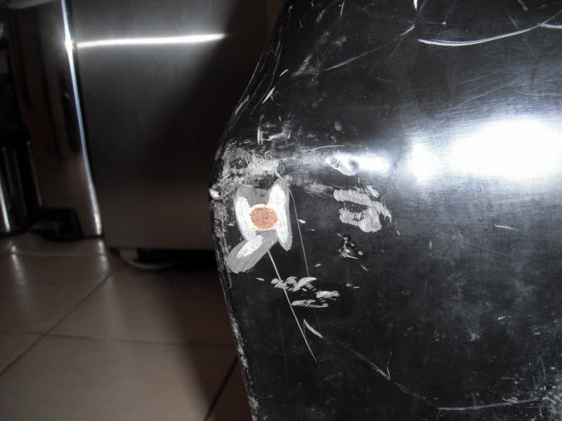

...but no base mounts.
I think I could get it to sit on the OEM sub-frame with some appropriate brackets. - It just about sits between the runners (in a similar way that the standard base does), but obviously there's nothing to connect it to... and the reclining mechanism gets in the way. It looks like that can be un-bolted from the door-side runner; is that right? If so I might be able to make it work... but I need the brackets and since Magnum don't seem to exist any more I don't know if any of the other manufacturer's will fit. - Does anyone know?

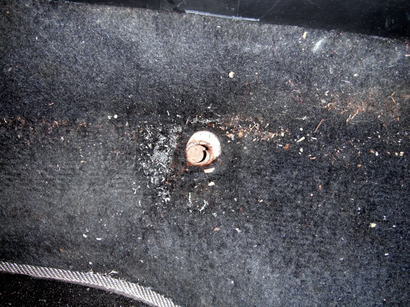

Finally, this is the bolt I had to drill-out to get the old seat out.
The drill did jump and bite my leg, which I wasn't pleased about... however I got the head off and belted the shaft through the hole (which I was pleased about). - Looks like that's just above the heat shield, so I think my plan to put one of those FIA backing plates under there and a 7/16 bolt through the seat mount is going to work.

Well, I've hit my first hurdle. - Magnum seats aren't a standard fitment on side-mount brackets; they're about 5mm shorter so the low-mount OMP brackets I've just bought don't bolt-up. :doh:
YBRacing said I can return them, but I figure I'll just drill a new hole for the rear mounting bolt; the front holes are designed to have a bit of adjustment, so if I relocate the rear pivot it should work.
