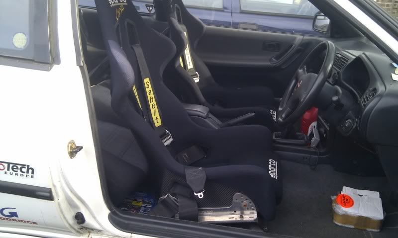

My set up.

My set up.
Whats the box under the pedals for Mark, you got short feet ?
That is interesting; seems the FIA give you a lot more variability on the angles than some of the manufacturers do. - Either way, it sounds like a better seat is my first point of call... then if I still think I need to be held down I might investigate the harness.
Your pictures are the kind of set-up I envisaged Mark.
That's my next modification, I'm going to wedge it under the brake pedal to make me faster :shock:

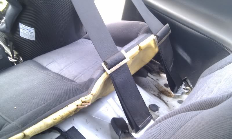

As a quick update, I won an eBay auction for a Willians 4-point snap-in harness. - It's evidently designed for use with "standard" seats because it's got the extra buckle to allow you to split it and let people into the back. I had a bit of a test fit, and I doubt it's perfect, but it does stop me flopping around in the seat.
I dutifully went-out and bought some 7/16" UNF harness eye-bolts and set about putting them into existing seatbelt mounting points... but that's where the problems start again. - I've got one of the rear mounting points changed (and it sits nicely under the read seat, so I'm pleased you can't notice it's there). The one that's behind the rear trim panel, I just can't shift; what's the best way to get that undone, find someone with an impact gun?
Also, because Jim so graciously offered to lend me his seat, I looked at taking mine out... only to find that one of the captive nuts seems to have broken loose. :doh:
Any tips for getting the bolt free; I'd prefer not to have to cut into my floor pan to get at the back of it? - I've got maybe 1-2mm of free play, so it's hard to get anything other than the head of a screwdriver under it.
I'm not sure what I'll do once it's out, but I'm very tempted to drill through, put one of those backing plates under the car, and use one of my spare seatbelt bolts.
Absolutely worst-case scenario: I give-up on trying to get the seat out, use the harness as-is, and if I crash I accept that I'm going to hurt myself... there's no side-intrusion bars nor air bags anyway. :shock:
