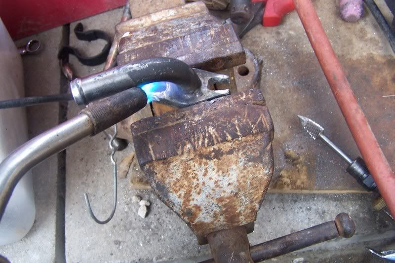

right first u straighten the old flange a bit

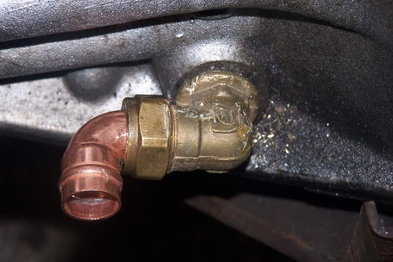

then make up a few plumbing fittings like this

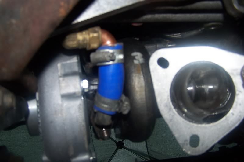

and looks like this when its done

3rd time ive done it like this and all have worked fine
ive tried hydraulics fittings etc and none are tight enough bends etc

ok can you tell me the tread size for that plumbing fitting, also if i made that up does anyone know of any companies that would then take that piece and make up a complete pipe for me instead of using the plumbing fittings.
ashills
the fitting is a 1/2 inch male iron to 15mm compression elbow and that goes into block and a yorkshire (ringseal)15mm male to female elbow
bopper
Thanx matey, i will go and get them tomorrow, now i just need to find a company that will make a pipe up with that design.
bopper
OK all sorted i got a company to make up a complete pipe, and got the braided hoses from hosesolutions sorted so gonna get it plumbed in on the weekend
