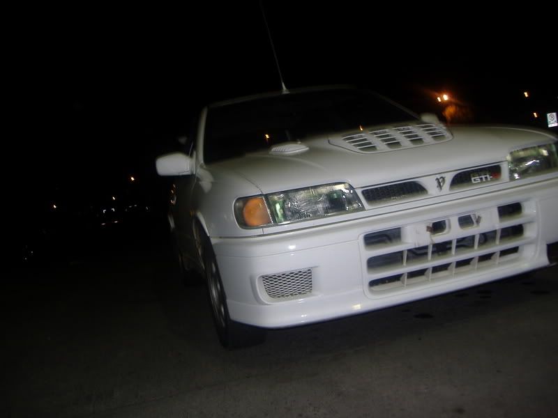

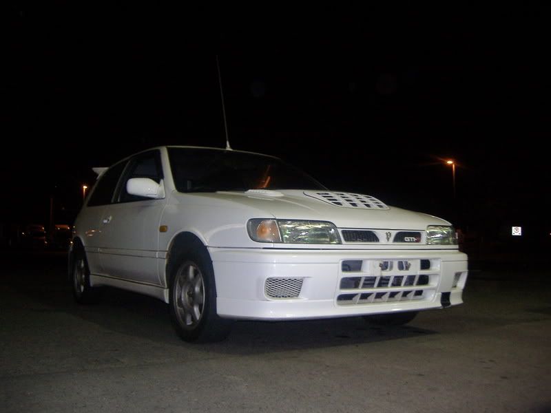

Ok, I introduced myself in another thread, but Hi Im jen.
Ok, so I have a 91 R, with only catback 3" and a turbo timer.
Tell me everything I need to know about this car. Its faults, what breaks often, the the first thing you modify, the brand of choice for modification of certain things, etc. Basically, what should I expect? What do I have to do? I want to drag race this car, I want it to run about a 12 in the quarter. Stock here these cars run between a 14.5 and a 13.8 second pass. Depending on the driver. I haven't done a base run yet.
