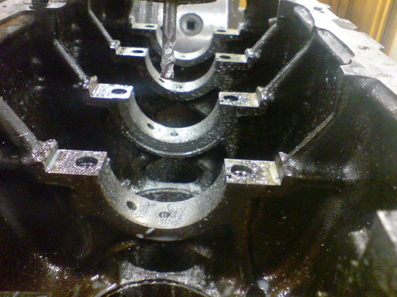

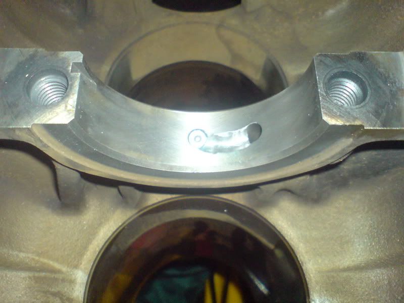

does the sr20 not have any kind of piston cooling? when i build a c20let engine for my old nova i fitted oil spray jets from the 2l diesel vaux engine, i had to drill into the main bearing journals and grind in oil ways to the jets, but maybe this could be a good modification to the sr20 if they dont already have something like that?
williams
pics of what i mean
in this 1 you can see where i made the new oil way, the jet is also fitted in here

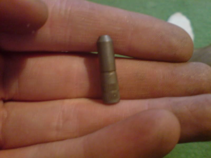

this is 1 of the jets, not that expensive from vauxhall
yes there are oil squirters to pistons in place already marc

there is not need to renew them unless physically damaged, they are not valves but always open calibrated jets and the strength of the oil jet they produce is dictated by the blocks over all oil pressure...........

that isnt actually correct for godsake:lol::lol:
they are opened by a preset spring located within the securing bolt for the jet itself.
assaid theres no need to renew them but its a good idea to run carb cleaner through the small jets to make sure there are no blockages
also make sure the spring is free to move in the securing bolt itself

Opp's, I stand corrected, I forgot about the mech in the block, I'm getting rusty in my old age, maybe I'm gunked up and need some carb cleaner :lol::lol::lol:
