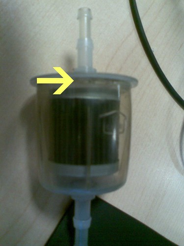

The culprit? A small split in the seam of the inline fuel filter, something I had meant to replace when I first bought the car back in September, but then totally forgot about until this rather aggressive reminder:
A brisk walk home and a rummage through the mechanical graveyard that is my shed paid dividends - a small piece of 8mm brass pipe, which I managed to put in place of the homicidal fuel filter until I could get the car home. One new Nissan OE spec filter ordered for collection ASAP.

Whoever fitted that filter wants their arse kicking....I'm surprised it lasted 5 mins nevermind from before you bought the car!!!!
Al Mac
Agreed - my own stupid fault for not changing it sooner though!
What sort of pressure do these things get up to when the engine's running anyway?
Are those carb inline filters or do they do them for EFI (+turbos) too?
You fuel pressure is 3bar base plus turbo pressure so an easy 4bar or 58psi
All efi cars I've had have had metal filters.

From the colour of the filter and the plastic housing, I would guess it's been on there for some time. Makes me shudder when I think about it now :lol:

I use them filters on the mowers and golf buggies i work on! Cheap filters, about a pound good for my machinery, clearly not good for the R :doh:
