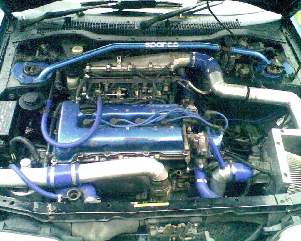

this is the engine here she wasn't fully done at this stage will get a more up to date pic but the only diff is the oil seperator is now hooked on and little bits and pieces
