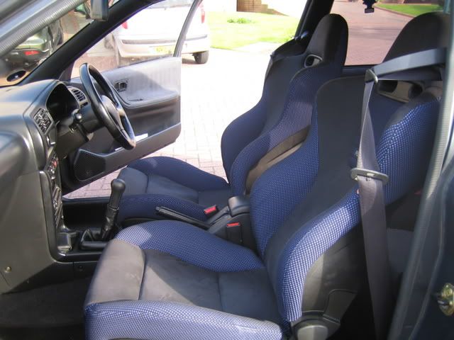

EVO Recaro seats fitted............

very nice 8) well done in fitting them. whats it like for a passenger to get in the back ?

I paid £275 for them from a lad on the MLR, picked them up from skeggy on my way down there last week. Bargain :thumbsup:
Aye, bens welding is spot on, well chuffed, still think im gonna fix some black trim on them.
It wasnt too much of a mission, I must admit when we started it, I was thinking it was gonna be a pig, but it was easy peasy !
As for getting in the back, you have to slide the seat forward and wind it up, but I hardly ever have passengers, so thats no bother
Il be leaving the reacros the same colour and maybe keep my eye open for some door cards and rears off an E6 to pinch the material off, Otherwise, Il just use black alcantara.

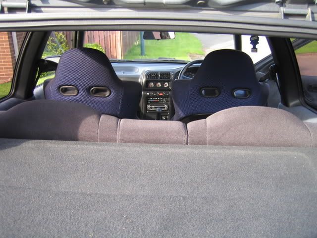

heres another few pics showing how they look in the car
nice view from the rear
perfect for a set of harnesses for track action Browny

forgot to say they do look and feel excellent when youre sat in them, plenty of support.

Top quality write up! You say they sit ever so slightly higher than the standard seats, would you be able to get them lower using different subframes?
PaulB
Hmmm, no, the extra heigh is in the seat really, padding etc.
Only an inch or so.
Davey Red R has them in his car now, so maybe he can give his view?
davey red.r
id say probs an inch higher at most over standard seats they cant be lowered anymore for the shape of the floor near the gearstick as it pertrudes out and up a bit.
