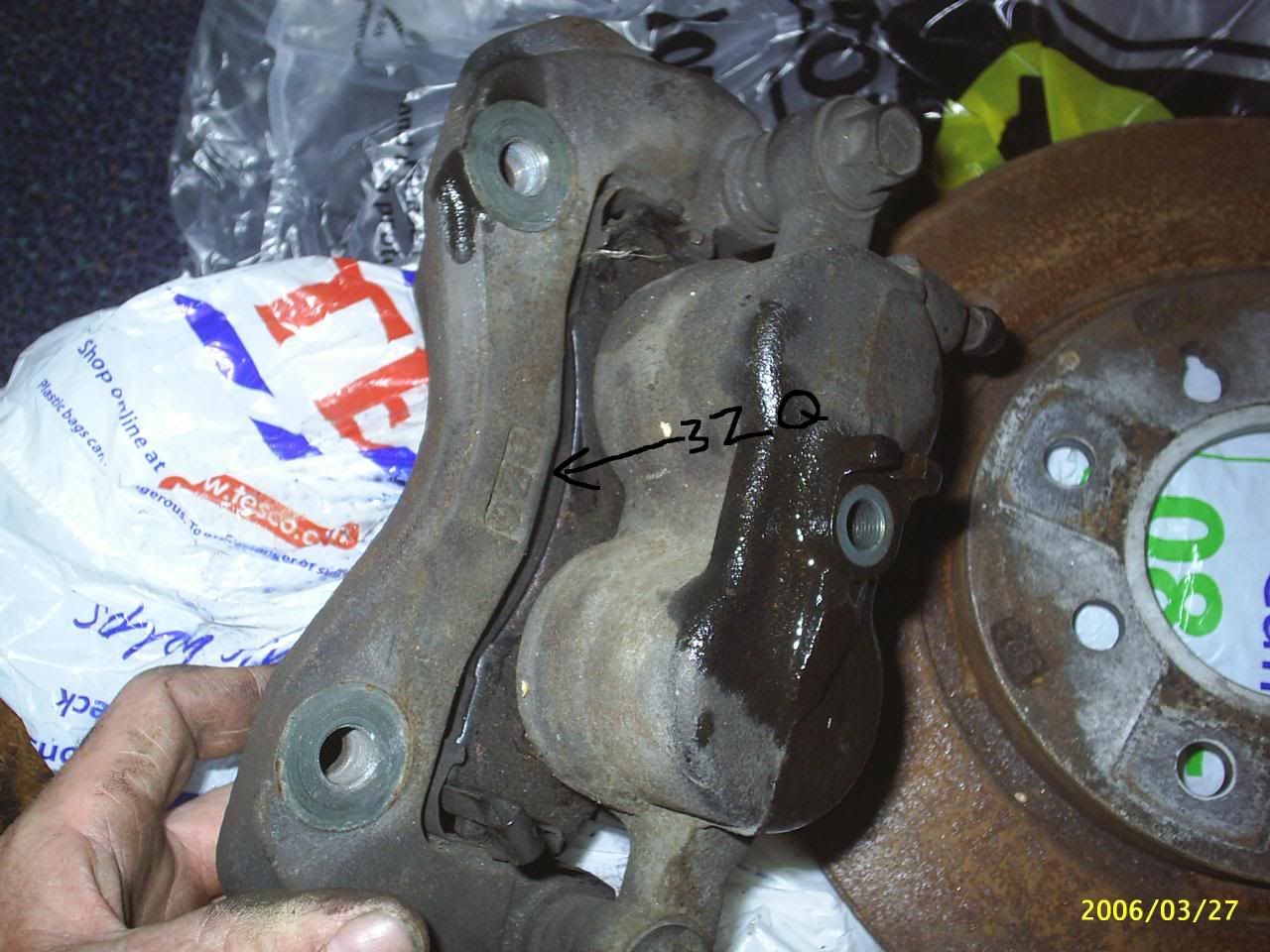

thought id take a few pics to see if we can get a little confirmation on the sigma calipers:-D
to me they look the same but i have found 3 sets of numbers you could check, my calipers came from an evo3 im 85% sure:lol: iv been told that the 1-3calipers are exactly the same anyway;-)
number shown is 418
clicky
number shown is 3ZQ
clicky
number shown is 2207
clicky

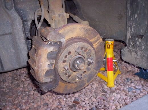

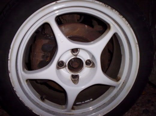

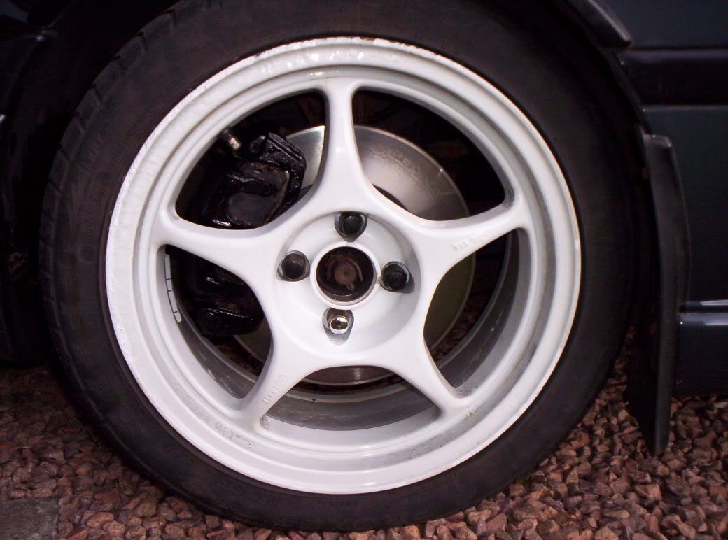

gtir bean
ill try and check the numbers on mine.you need to drill the holes in the hub to 12mm and ellongate one or both of them sjightly with a file or whatever.the evo ones are very slightly closer together.the only thing thats different to look at is that the sigma ones have a screw fitting for the flexi instead of a banjo bolt.not the best pics but i will get some with the wheel off when i paint them properly.

Just had a look at my Evo calipers and the only numbers that match is the 2207. Mine are from and Evo 1 tho. Ive also been told that Evo 1 - 3 calipers are deffinately the same.
