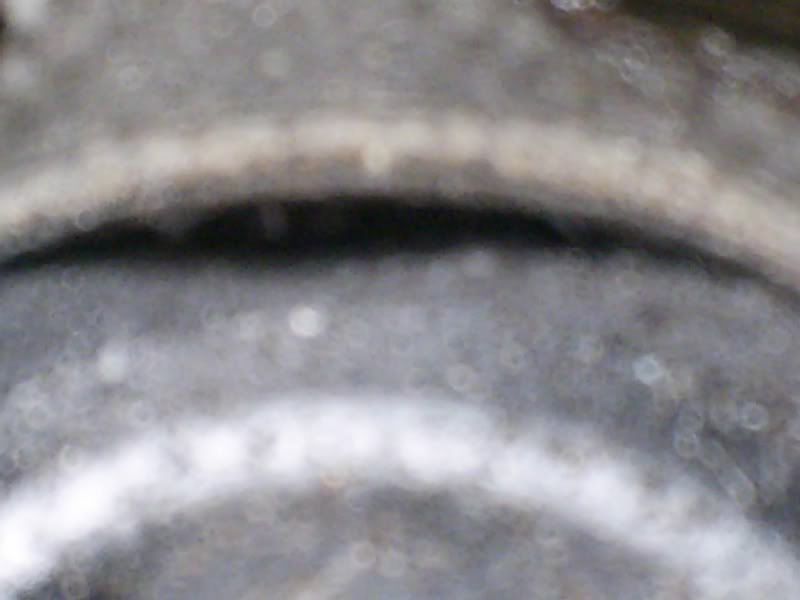

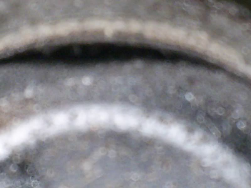

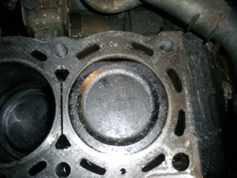

this happen last week and i took it to bits to day and now i got to take the engine out :evil:
Fusion Ed
You will probably find the above damage has happened over a long duration rather than sudden. I'd get your injectors checked, especially if all the other cyl's look fine.
Just to add, if you do decide to do this, bag them up and label them so you know what one was where if any problems occurred.

i thick it wos like this fan i got it i have had it 4 weeks now i will do label them up thanks

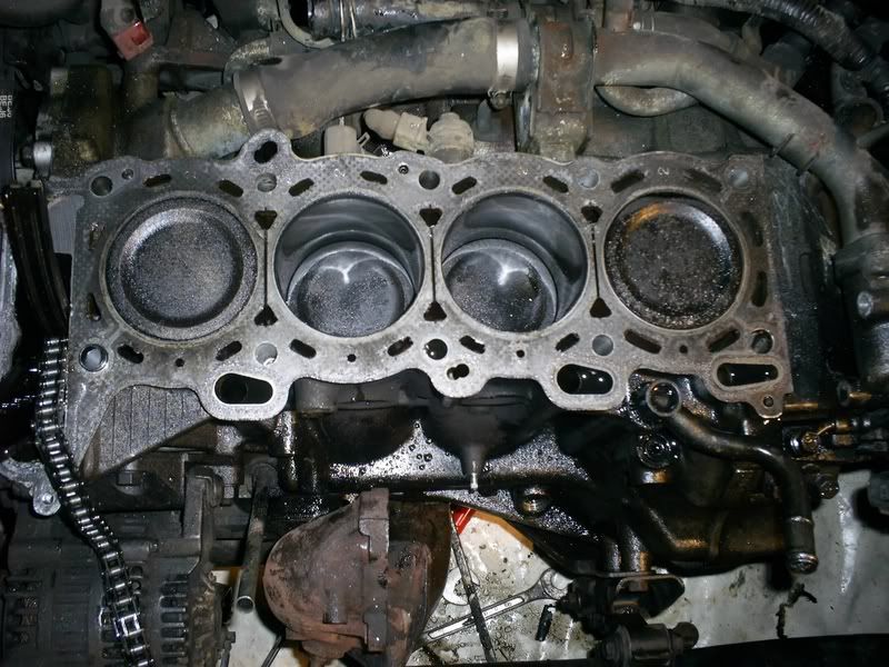

Looking at the first pic, No1 cylinder seems to be very dark / oily, do as Ed has suggested and check or replace injectors, possibly look at the fueling and make sure its running as should.

thanks for say coz i play abut we it to got the CO down on it for it m.o.t then i get it fix i will get it set up so it right thanks.
