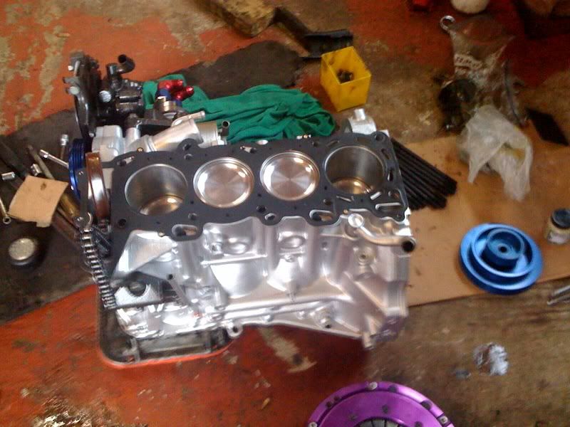

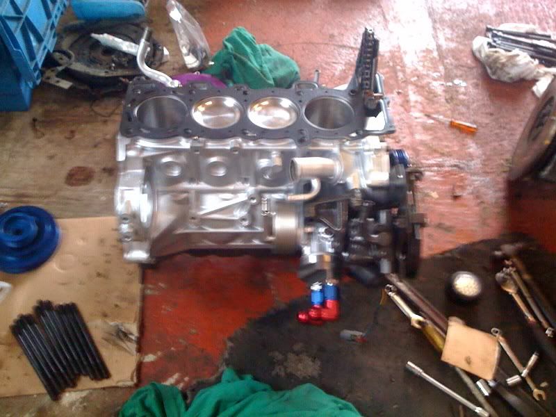

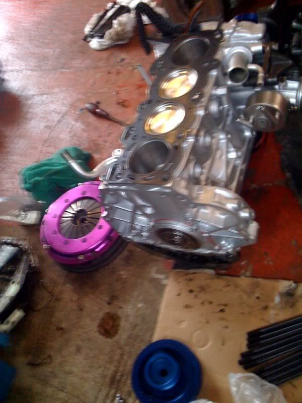

more pics of new short block
Was doing really well yesterday until the chain dropped... will have to take the sump and oil pump apart again. good fun thou
frit
Im pretty sure you dont have to have the chain mark on the crank mark, just make sure when you're timing it up that the camshaft marks are pointing in the right direction and there is the right amount of chain links (11 i think but dont take my word for it) between the marks on the sprockets (obviously piston 1 on TDC).
edit - Or have i got the wrong end of the stick and its dropped right in and you cant get to it?? :doh::lol:
nimhbk
Big thank you to Bob and Dan
The evc was about to fly out of the garage window
If it was not for their advice
Cheers guys
