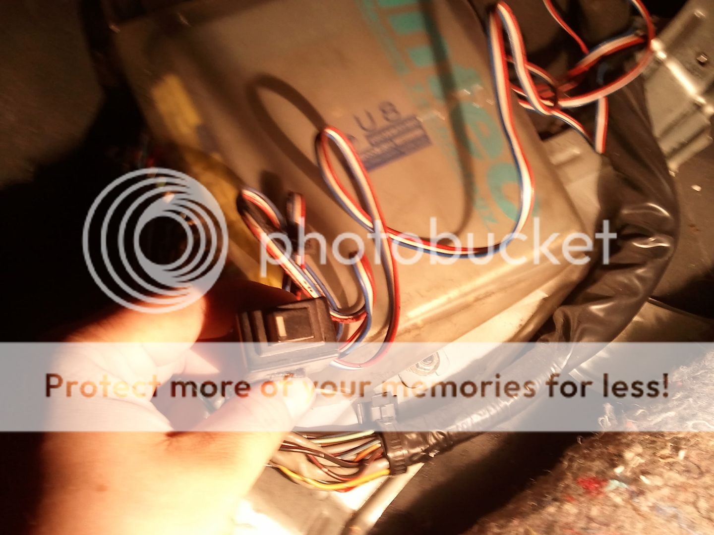

Agree with Danny.it looks like a switchable daughterboard setup to me
You will need a switch with at least 4 positions on it. Attach the wires so it runs and then work out in which position the maps change. Keep playing with it until you find the map for : standard = 1, 14.5psi = 2, 18psi =3 and so on. Keep an eye on your boost gauge, this will help with the boost levels.I thought switchable daughterboard but not sure how to switch maps. Forgot to say it's a intec ecu.
