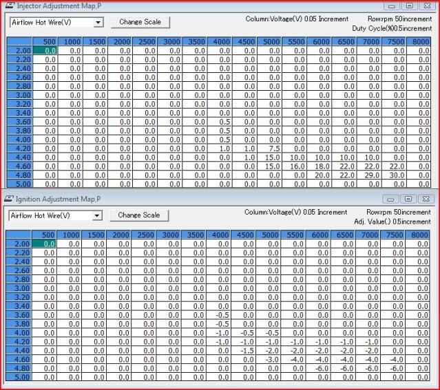

here's my map the only 2 that have value in it.
to better tune my emanage, should i use the "A/F target map" ? is it a good start ?
eveything is standard exept intake & exaust.
