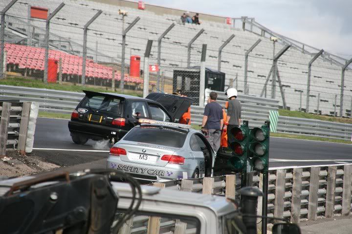

on the pit straight i hit the limiter in 3rd so i go for 4th nothing (shite) go for forth again engine revs (clutch down quick) by this time it was to late. think i may have selected the wrong gear :doh:
there was loads of white smoke

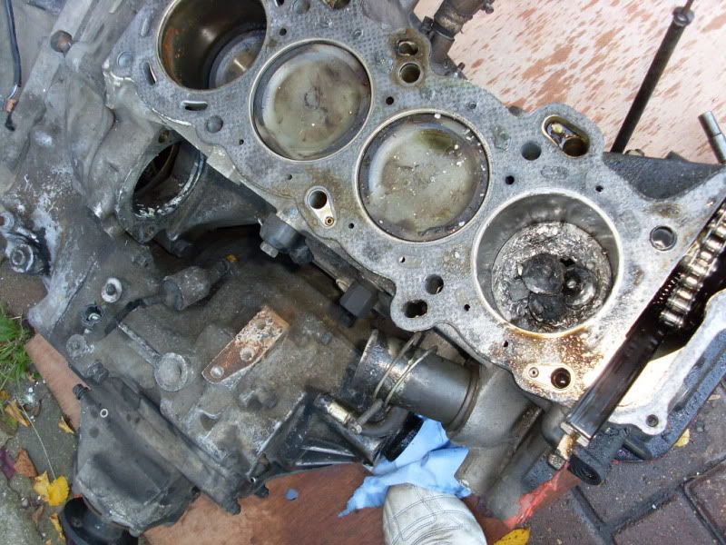

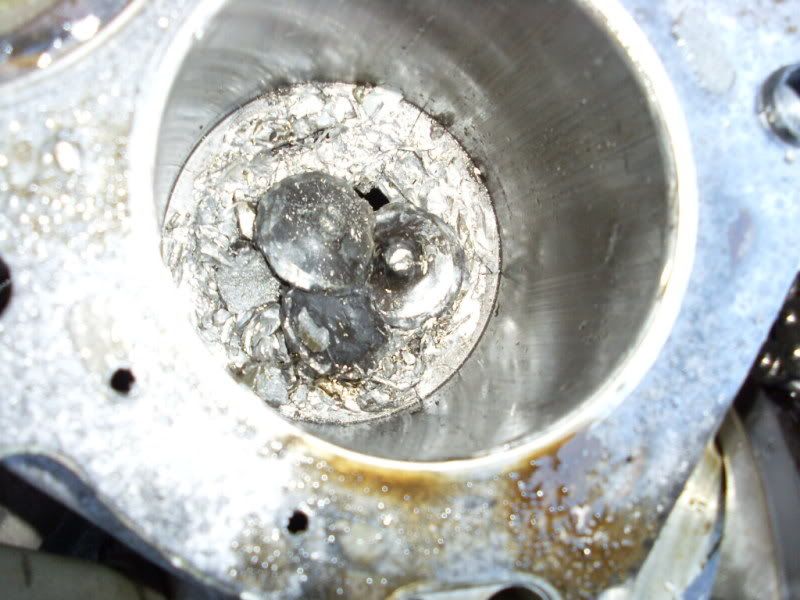

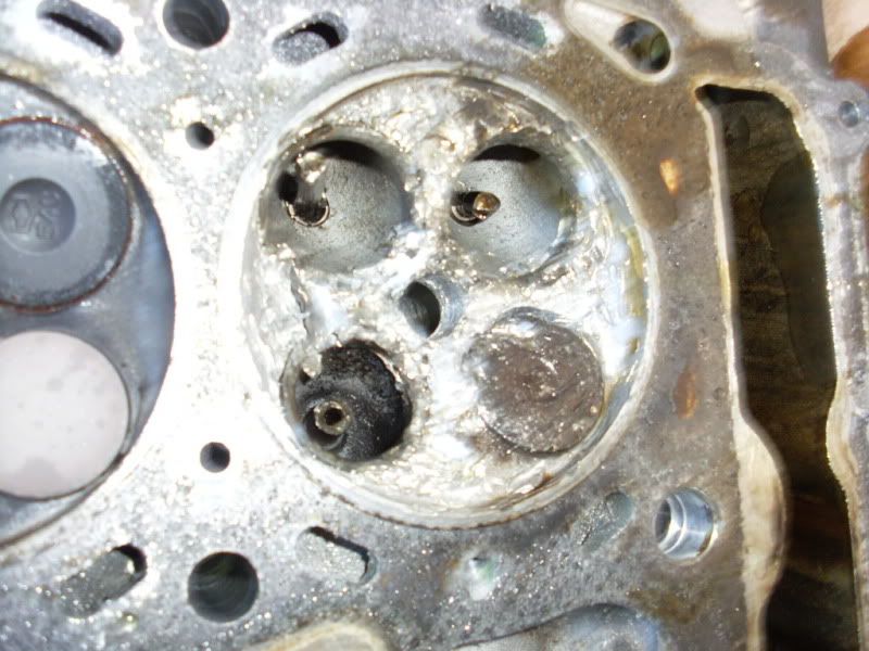

so we get my car off track to discover this doooohhh

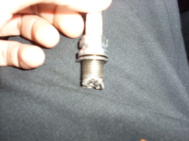

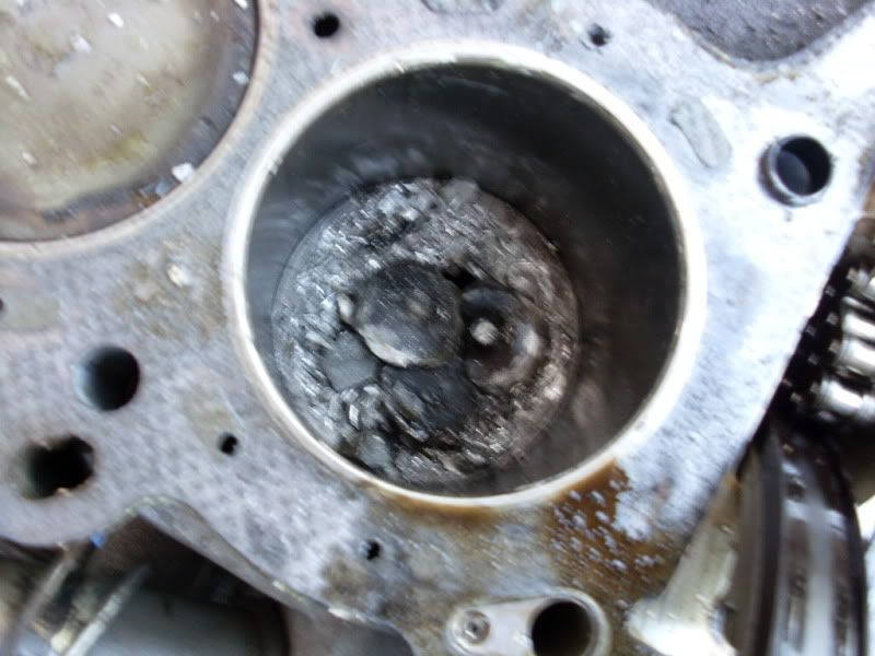

over reved it dropped a valve piston come up smashed valve into spark plug. you no the rest.

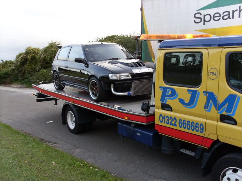

day started like this
and finished like this
messy spark plug.

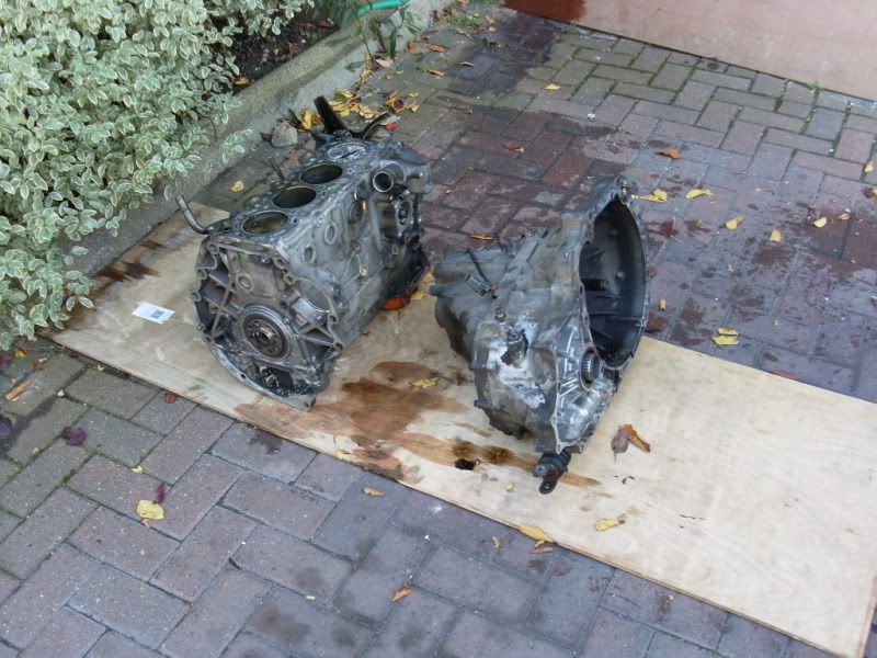

Sound's like you might have lost 4th gear too,If you are confident enough take the end case off the g/box and check it before you put it back in the car.
jamesgtir
i will strip the gearbox red reading, not worth the greif of putting the lump back in to discover the gearbox is gone.
Just remember to take out the 2 detent bolt's and spring's with the ball bearing's and the reverse idler bolt before you try to take the endcase off as the bearings fall deep in side the caseing!
its a pity i cant find the pics of ollies engine that we had to scrap, it seems ive deleted them.
was the biggest mess ive ever seen in an engine....smashed piston, valves dropped through into sump, holed block, broken crank and pebbledashed head lol
it was deffo unservicable:lol:
im guessing yours may be a similar state james.

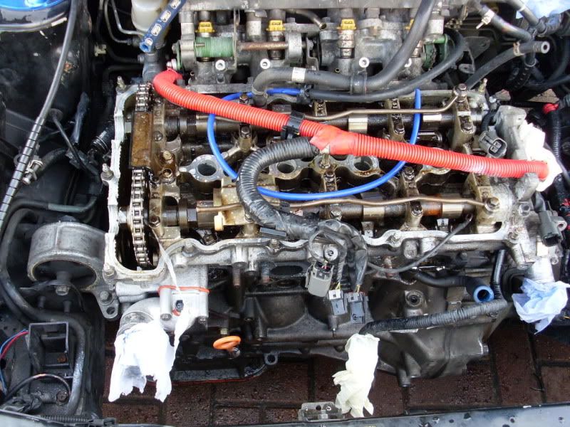

well the engine is ready to drop on the floor just dont think il get much done today as the weathers looking bad,

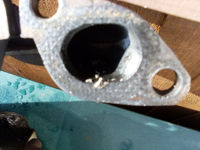

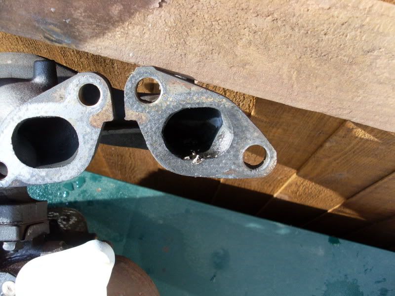

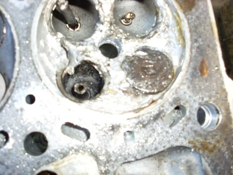

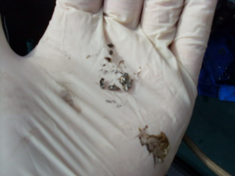

update on this
turbo cylinder 1
the swarf that come out
the engine will be out tommorow.
This is the picture that won't show in your thread (even though I've edited it to use the same code as here)
its a mess but not as bad as the one we had in which holed the guys block lol
