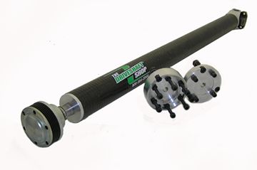

i would have to check the bolt pattern and more then likely make aluminum plates like in the picturethe length is*1850*Millimetre(s) =*72.8346456693*Inch(s)*i make a 3.25 diameter carbon shaft (thats the size i believe you showed me on the carbon 2 piece) for the**new SR*, we can go 72" with no problem with a high Modulus tube and can spind 8000rpm. one picture would be what*the shaft looks like (th CV is 108mm in diameter so you would have to tell me if that will clear, the diff usually has more room)the 2nd picture is one of a car with a 72" single carbon shaft.*

is this a independent rear or solid, the shafts you showed me only had a slider on one end. i have been doing this*for over 35 years. if you want to work with me i would glad to. all you need to do is give me the same dimension**you did on length with the suspension compressed, ride height and extended.* there is not allot (maybe 1%) of vehicles*that move the suspension so much that 1" would not be enough. we could also just put a CV on each end. the benefit*of the single shaft would be very noticeable. if it has to be a 2 piece i can do it also but normally its one done if critical speed*cant be covered.*
