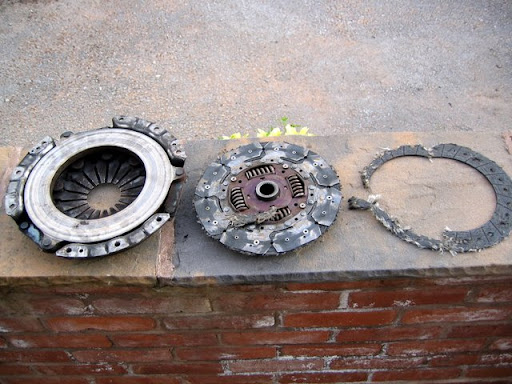

It may sound blindingly obvious, but check you've got fluid in the reservoir, and that it's not pissing out somewhere. - My plate let-go because the clutch fluid had leaked over it from the slave cylinder, but if that's the problem and you change it soon enough, then you won't destroy the plate.
This is what you get if you let the fluid get onto the friction surfaces:
