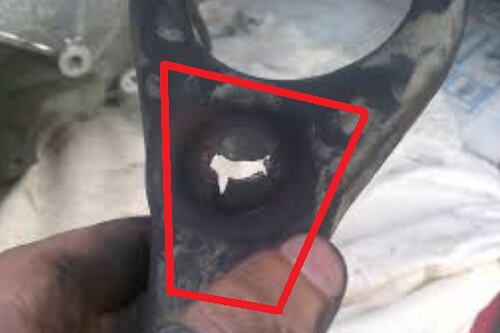

Many people had to reinfored their clutch fork because performance clutches can be very heavy and they spring forces were so strong they would bend/puncture the clutch fork.
Mine had punctured a hole though the release fork making gear changes almost impossible.
I ended up having some 4 or 6 mm steel welded over the fork and make sure it wouldn't bend or punture the fork again - which it has.

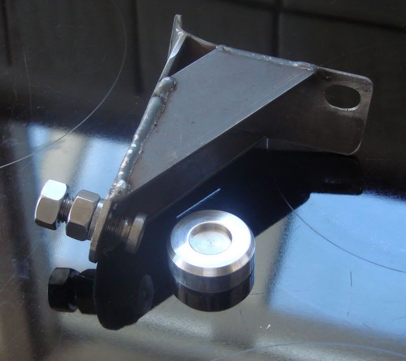

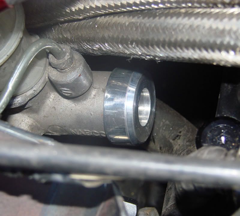

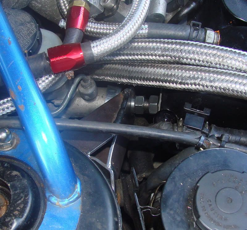

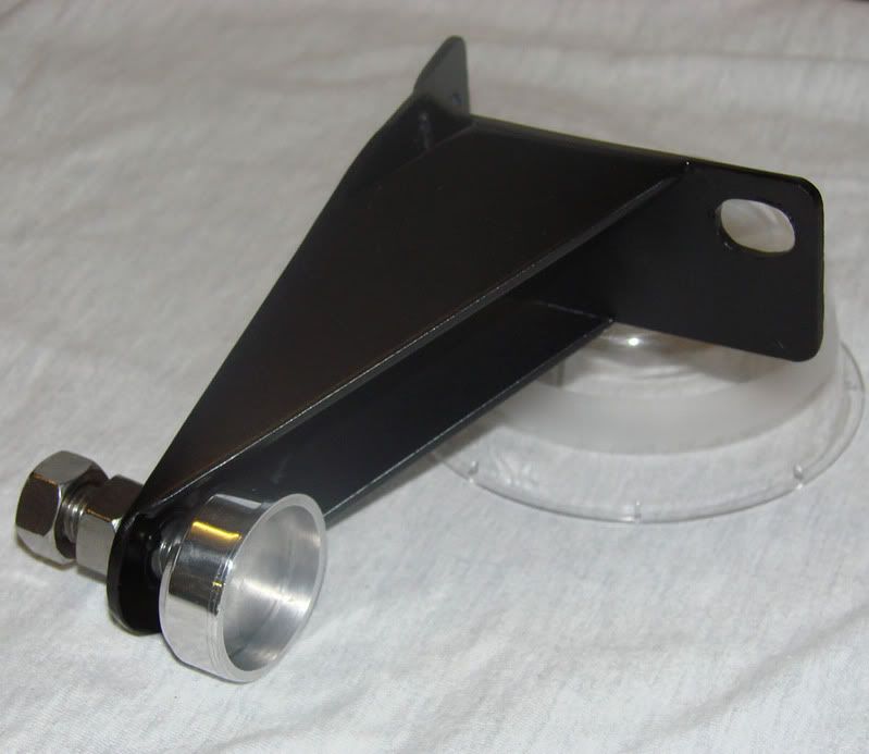

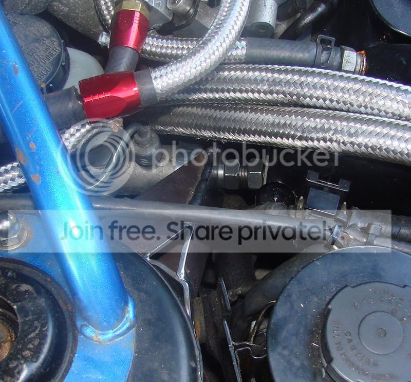

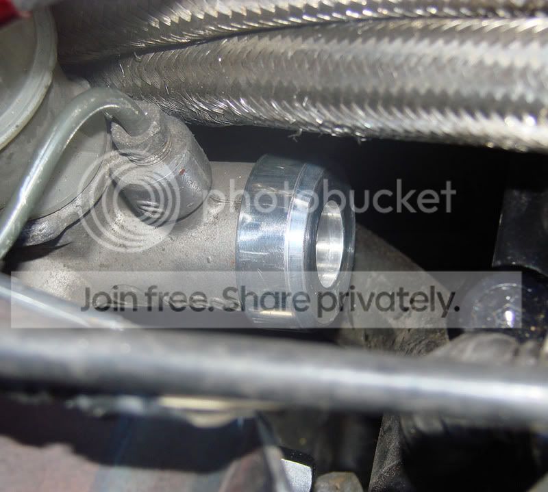

As for the Navara master cylinder...I used the bog standard OEM GTiR unit with a brake support bracket that was available at the time. (see pic's below)
I run K-Sport 6 POT brakes on the front and standard on the rear and the standard master cylinder was perfectly fine.
I've never needed to upgrade the system.
When the car comes back on the road I will look to upgrade the rear system at some point, but it might need a little help if I change to a AP Racing rear conversion...
Overall I'd look at welding some steel over the fork the next time it comes out, but the rest of the items aren't really needed unless you're having problems.
I'd look at making sure you've got the clutch support bracket (a small bracket by the clutch peddle)
99% of cars should have this item fitted by now, but worth quick check...
Link to that bracket -- Clutch Pedal Support Bracket

Thanks for this Andy, it was interesting to read. I've learnt a lot from you on here over the years and i appreciate you taking the time to upload those images to make it just that bit clearer.
