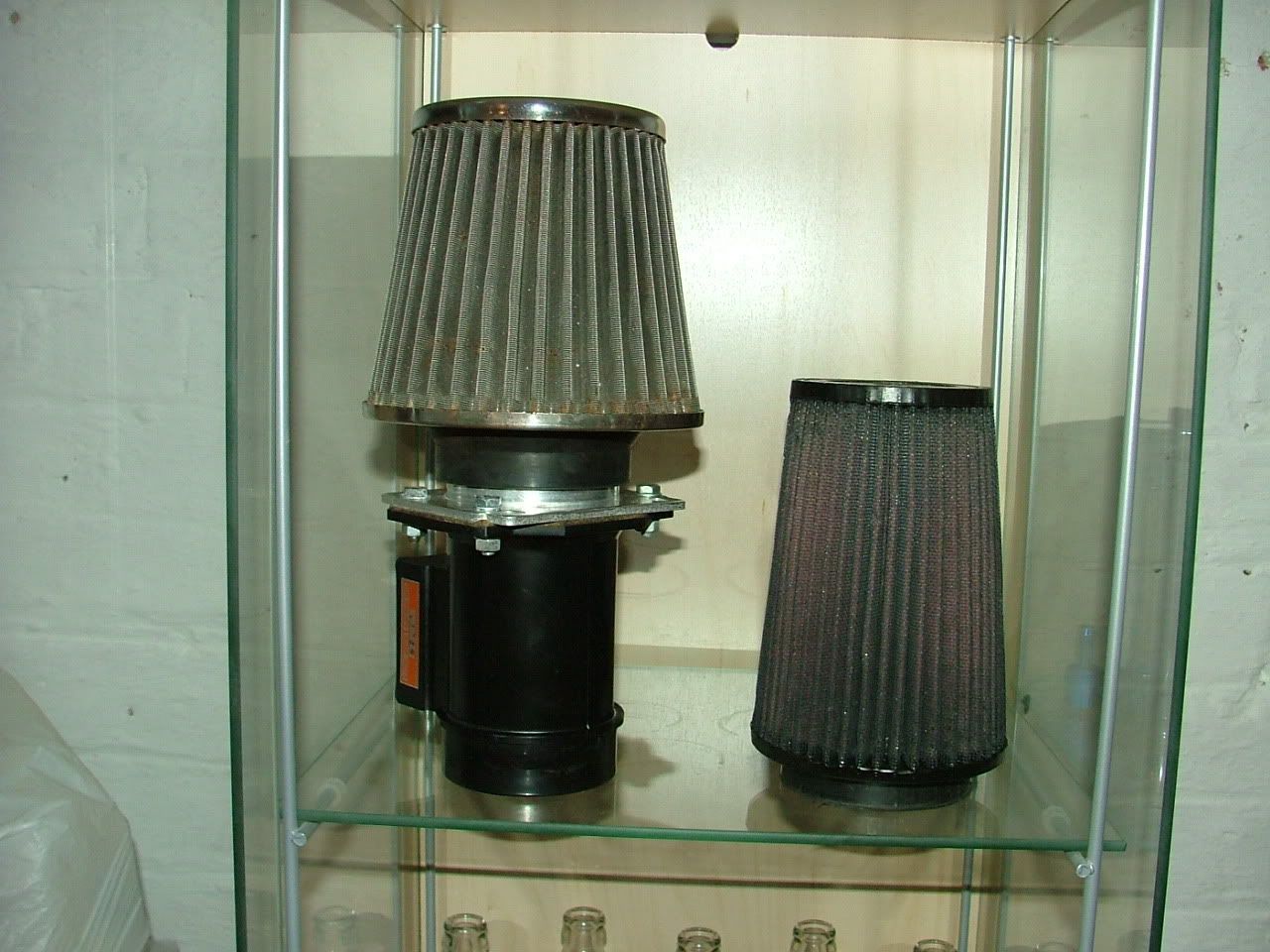

If you're using a decent filter ie K&N, Green etc etc then you need to have a large filter so that the airflow /sqinch is low.
I would use a minimum of 200mm long and 150mm wide but bigger is better.
this is my setup,
