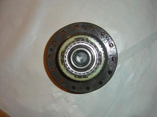

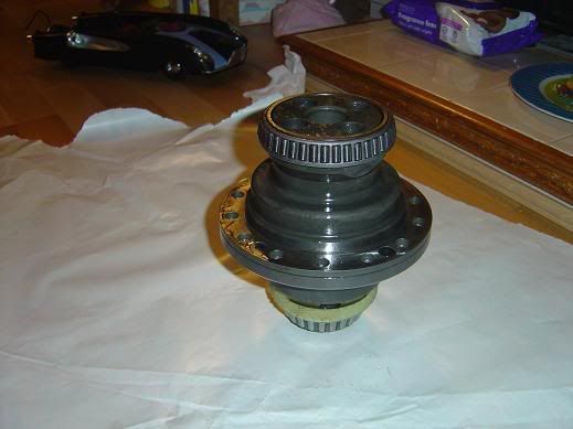

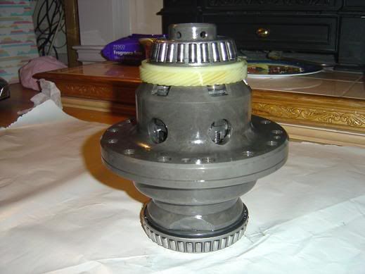

Dee 1 said:
Got hold of this a few weeks ago for the R its a CUSCO MZ one way LSD
but i dont know if its for the front or what or if one way is any good????
Anyone know
LOOK CAREFULLY
it is for N15 30 series box
look at the no of bolt to the final drive..
14 bolt opposed to GTIR which is 10 bolt
nismoboy
It still might fit with a bit of modification. Also there could be other options for lsd`s for the pulsar. 300ZX has an lsd could this fit? 200sx? Any one know where u can buy the nismo diffs from :?: and how much :?:
zia
for the pulsar. 300ZX has an lsd could this fit? 200sx? Any one know where u can buy the nismo diffs from and how much
checker flag to both front and back but ain,t cheap at £600 each plus shipping
zia
cmng
nope
30 and 50 series LSD wont fit each other
size and bolt is big different
as well the drive shaft size
Nad
I posted a pic up a while ago of the positions of the diffs. I think people get confused with what the diff and transfer case does. You need the diff where it can be controlled mechanically, stuck after the transfer case it wont be able to do this.
The front driveshaft run thru the centre diff, and are controlled by it whereas the centre diff runs around the front driveshafts to control the rear via the transfer case. Think of it as two tubes, one inside the other.
Nad
P.S. Dont quote me on the above, hadnt had a proper look, only from poor photos.
