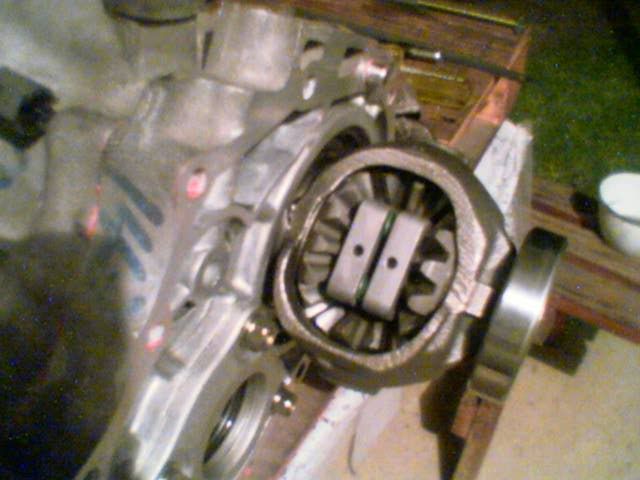

there is couple of way to make the front diff into lsd easy way is to weld them togeather (not practical but possible)
another way
nicked pic from cousin,s downunder :wink: (hope they don,t mind)
zia[/img]
