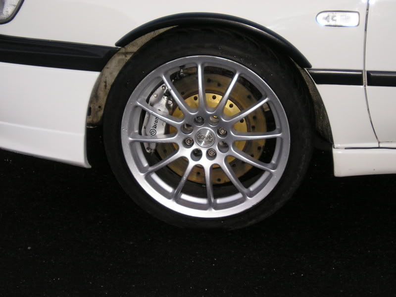

fiat coupe turbo brakes have these been fitted to a r, will i just need a caliper spacer plate made up.
Its a fairly simple design spacer.
Mine was a kit that used to be supplied by Hi-Spec and incorporates 330mm rotors on allu bells.
Ben.
nimhbk
Going to try get these under my 15" with 280mm fiat turbo discs...
Need to find a good place to get some wheel spacers any ideas
