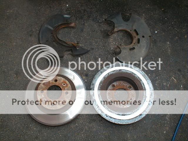

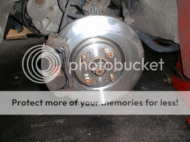

all done :D
no wonder the old ones were not working very well, looking into the wheel, the discs looked fine, but the back of them :( as you can see in the pic, the pads were only touching about 1/3rd of the rear of the disc.
jasegould
:shock:
Let me know if they are any better once they're bedded in :p
