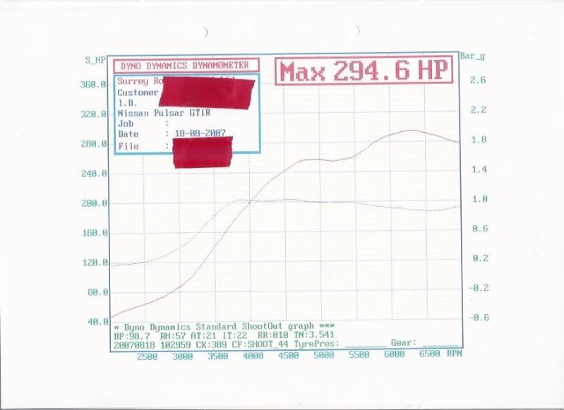

lol its doing my head in now just thinking about it,heres a graph of what mine was doing.

I'm thinking it might just be better to fit a stronger spring in the actuator rated to 1.15 bar and remove the Dawes device, wouldn't this be better?
Is this a dawes device or just a cheap ebay lookalike ???you do know if you only use the actuator as a means of controling your boost you could be running at almost double the spring pressure.
