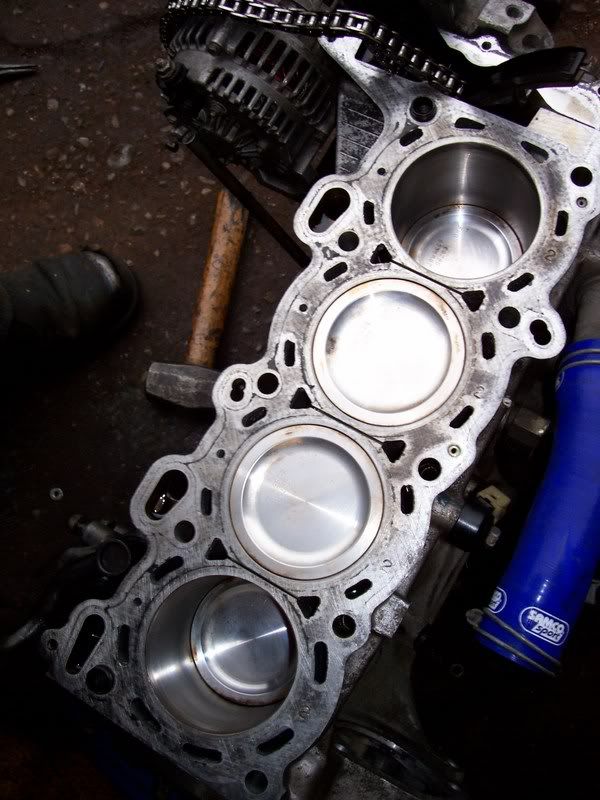

here is the sorry state of my engine!
worse than i thought, pistons and bores are fcuked, not good at all. very very p***** off.
photos to follow

That looks nasty :shock: :doh: , Bobby your photography skills are worse than mine :shock: :lol: :lol: :lol: :lol: :lol: :lol: .
Are they forged pistons ?, If so that was some really class mapping :shock: :evil: .

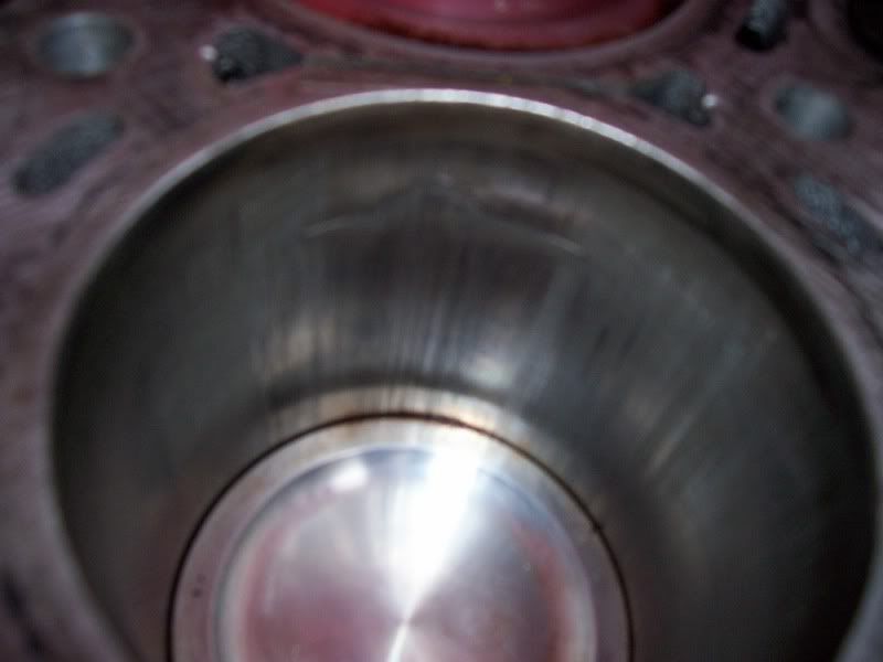

thanks mark, none too pretty is it, just goes to show what can happen with immense overfuelling:shock:
bores were washed clean of oil, rings and ringlands overheated due to metel on metal friction, leading to the horrible mess above.
blocks boogered too as it was bored out to 87mm and the gaulging must be 1mm deep in places!
basically the engine is now fooked:sad:

That is bad:shock: What do you think happened to the side of the piston?
Bore washed then hung up on the bores then got major blow by and melted them?

oh dear now rob please explain how damage to the bottom half of the piston would be due to mapping wouldnt the crown have been damaged first looks like bobby might be saying sorry to someone

yes my photography skills are somewhat lacking. and yep wiseco forge pistons with teflon skirts.
and yes rob, a true classy bit of mapping which has cost me a lot of money and time, but il say no more on that!
just be warned everyone, forge internals are not indestructable, wrong fuelling will booger your engine in no time at all!
in one:-D
too much friction and heat due to lack of oil, then kaboom, meltdown!
quite the opposite alan, think that someone owes me an appology as well as money for postage and breakages, as well as damage done to my engine

bobby come on mate the top of the piston is perfect the bottom is damaged how can you still keep this up
looks like its been run in softly like you said in a post earlier when it was rebuilt then when it had some heat through it the expansion made it catch scrap etc but i may be totally wrong
gtirx2
Yep the bores have definitely run dry by the looks of it and it has almost tryed seizing itself by the look of the bores:shock:
Another option for your engine is the 2.2 big bore kit from here http://cgi.ebay.com/ebaymotors/SR20DET-2-2-Liter-Big-Bore-Kit-SR20DE-SR20-Darton-CP_W0QQcmdZViewItemQQcategoryZ33623QQihZ008QQitemZ180115842575QQtcZphoto
and then atleast you can keep the block?
But saying that i think for the price it costs to fit the liners you could proberly source another block,plus the liners at 90mm bore are at there limit they can be bored to,but saying that a standed block at 87mm bore is at its limit also.
