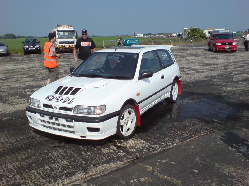

Front mounts look chav on gtirs though, i can see why people like the arc replacements.
They dont have too, mines got a front mount lurking away behind the bumper ;-) But i know what you mean, most people chop the whole bumper apart which looks all wrong in my opinion :?
Keira
you got yours cheaper than cheap, it doesn't count :lol:
although it does look good like that, car is looking well considered its owned by a fag :lol: did you notice a difference by swapping ? when you fitted it you hadn't done anything else iirc
I bought it off a right nobber too :lol:
I fitted my tubular manifold and turbo elbow at the same time so i cant say for sure about the differance :doh: But at interpro last year it made 305 bhp at just under a bar and two 1 bar R's with topmounts both made about 275 bhp, but im not sure how much of that was down to the manifold and elbow!
30 bhp from a frontmount, tubular manifold, and turbo elbow seems like a good result to me though 8)
