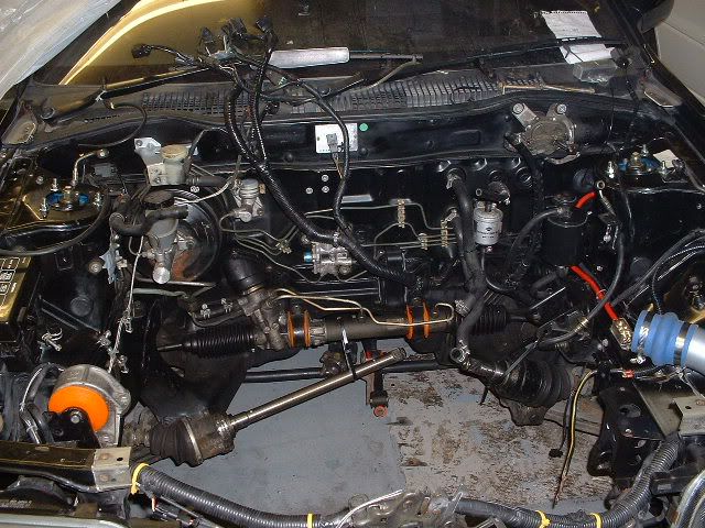

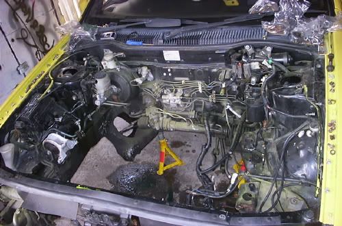

to completely remove the abs is a pain in the @rse :roll: :lol:
lots of bits to take out, re-route some lines and from looking at a non abs car and car with abs the distribution block for the lines looks different but i havn't found out why :?
they have a different end to them, can be seen in the pic of andy ( mr gtirs ) car and then compare it to pic of my yellow one with engine out
somethings different :? but they have the same number of connections to them, just without abs it comes straight from master cylinder, then to the calipers... will have to have a look through my manuals when i get home to find out why they're different, or if theres seperate part numbers :?
