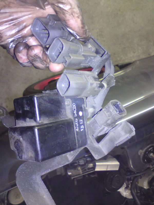

ABS ecu?
pschurr
If you're removing ABS, then you can dump this assembly.
As mentioned above, the black box contains two relays used by the ABS system - the relay that provides the +ve feed to the two actuator solenoids, and the on/off relay for the ABS pump.
All the loom connectors on it are related to ABS. Take it all out.

splmum
Rather than just throwing these away, flog them on fleabay, you might make a bob-or-two
