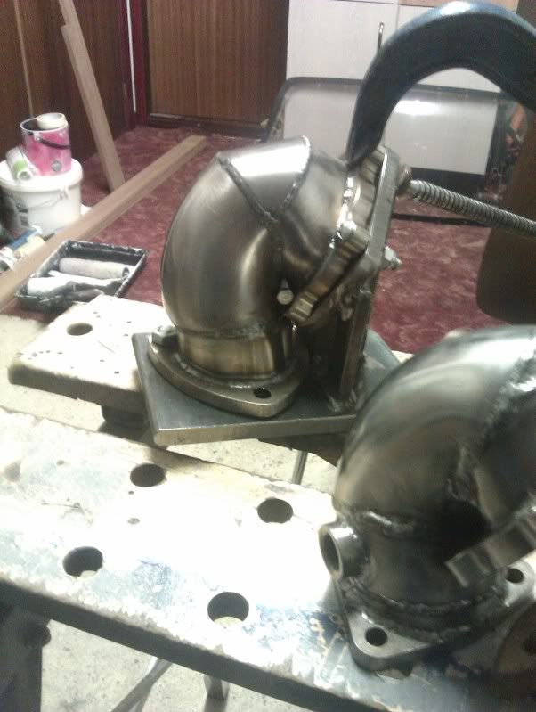

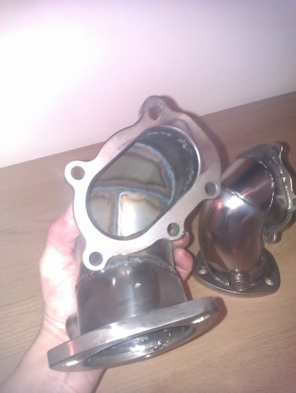

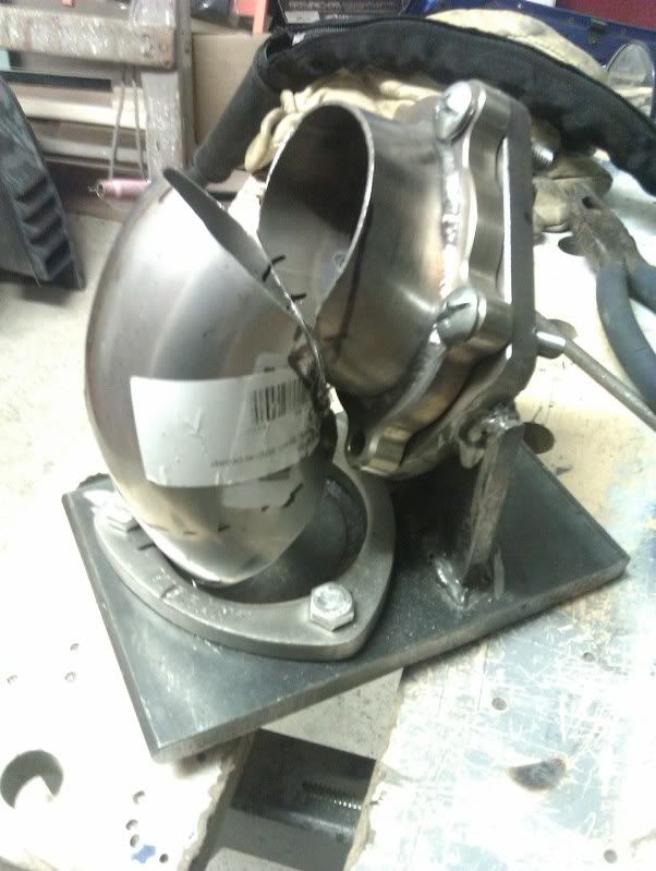

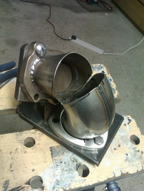

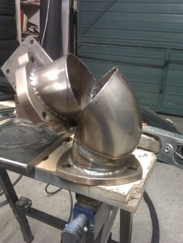

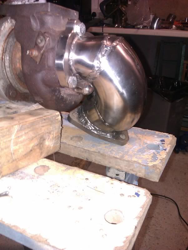

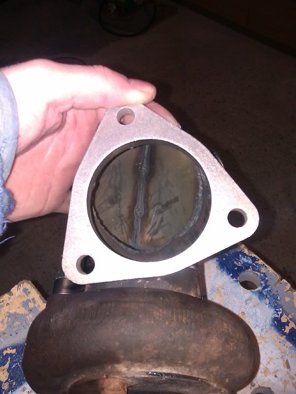

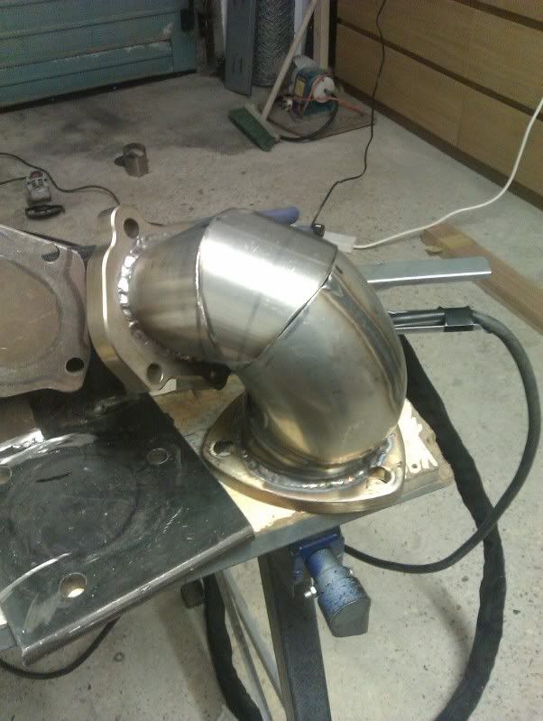

Been working on an other elbow with a 3" 3 bolt flange,

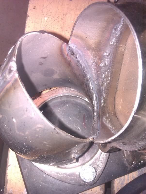

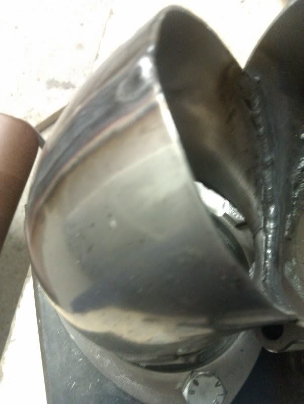

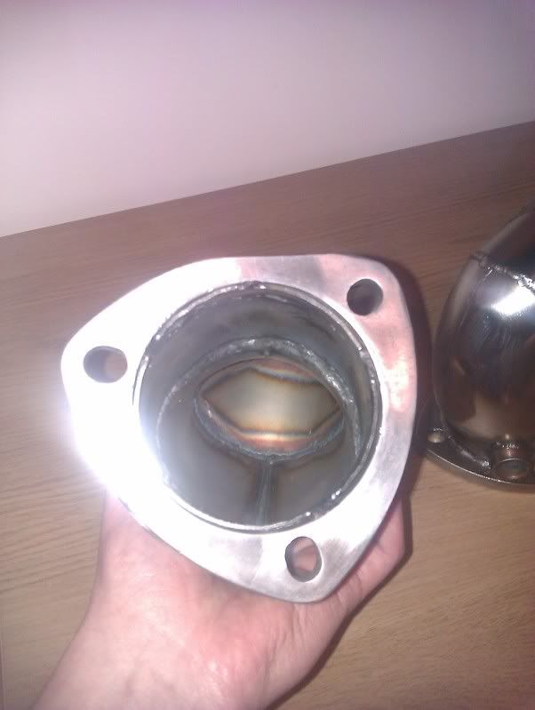

Instead of trying to weld in the tight bit of the elbow i left a bigger gap on top so i could weld in the inside ;-)
Every one i do is getting better and i think my welding is getting a wee bit better :) only been tig welding for about 3 weeks.

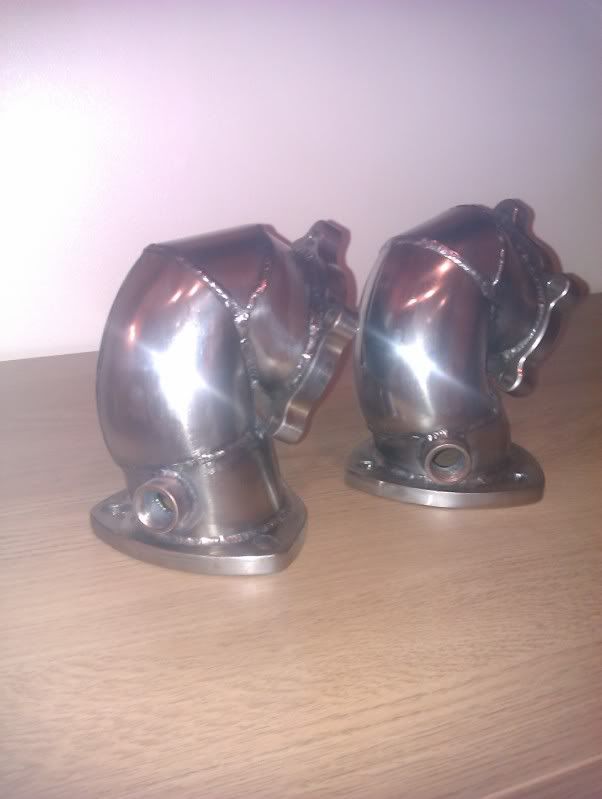

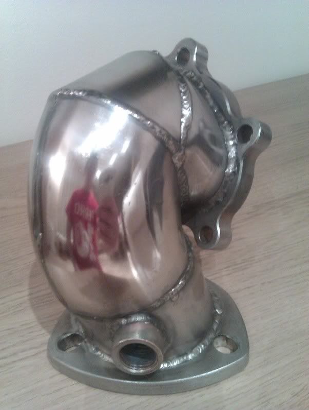

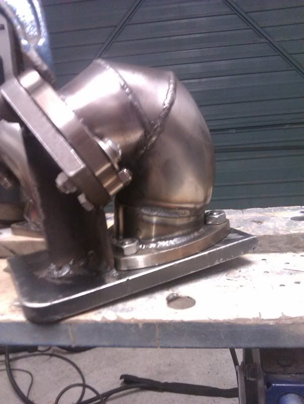

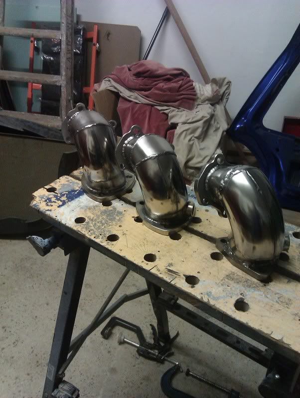

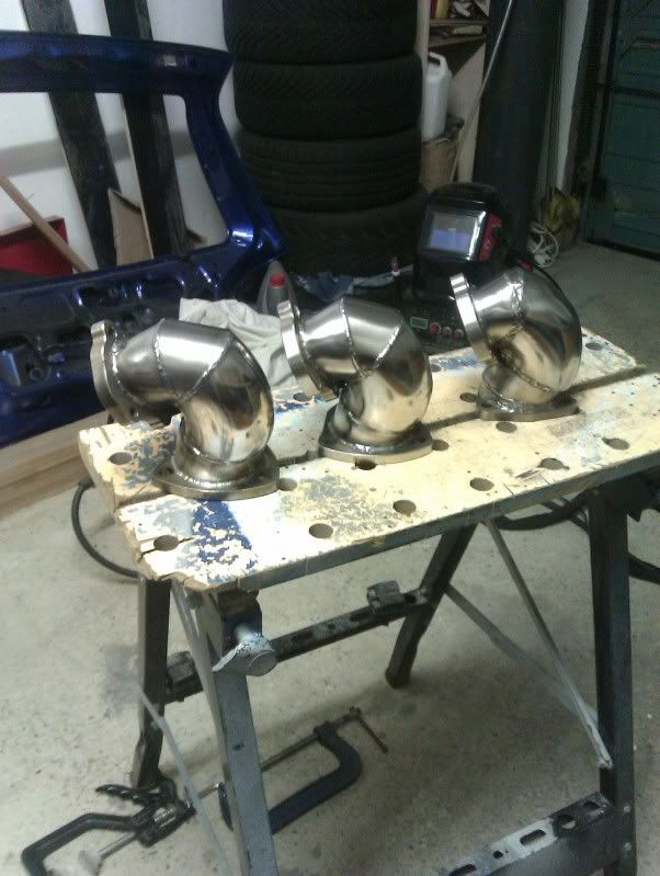

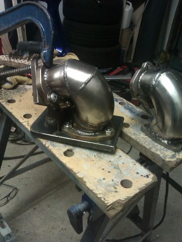

Last one looks really good Stu.If I were you I'd charge a bit more for that one rather than reduce the price of the others as the amount of effort gone in you need to make something out of it.

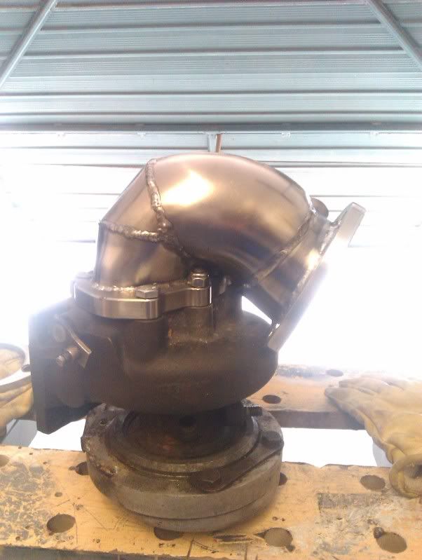

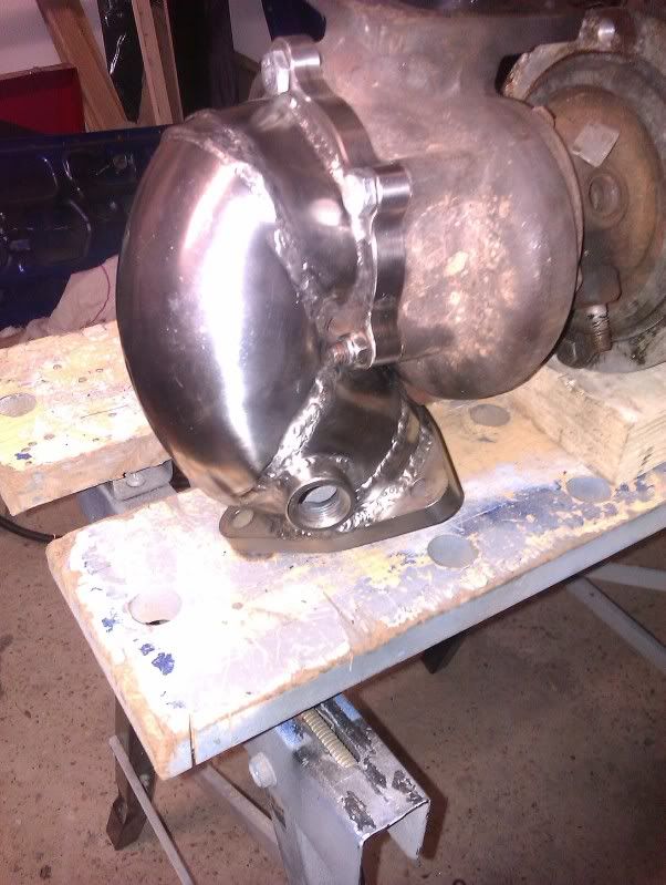

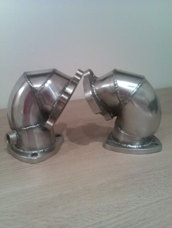

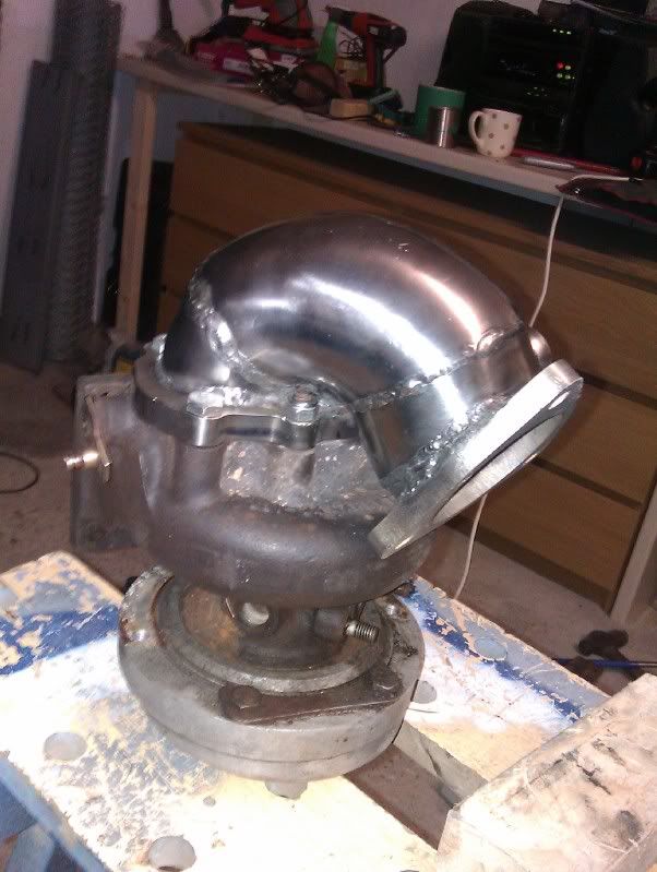

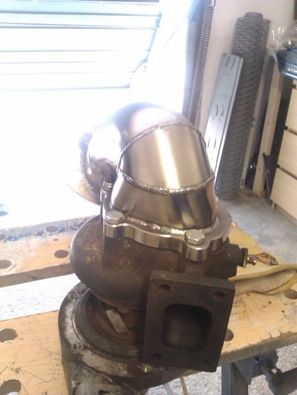

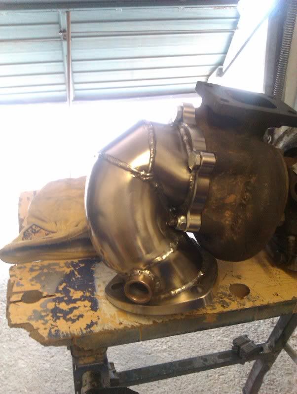

Tried one of the elbows on a turbo tonight and it fits, I have listed the one with the 2 1/2" flange on ebay.
Also tried the 3" flange one and it also fits, will finish it off soon.
