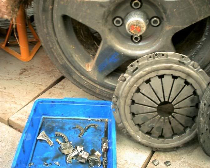

Its even worse when you find all this lot in your gearbox oil, and that was only about a 1/4 of it :shock: :lol: :lol: :lol:
time 4 a new box get used 2 it mate as its going 2 be 1 off many :oops: :shock: :lol:
Re: box
That was a while ago now :wink: That was my first box, i've had 2 more since then :lol: :lol: :lol:
