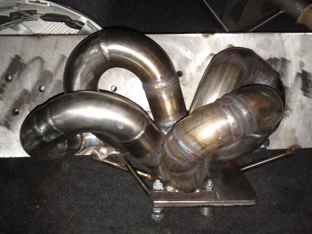

I am happy to announce that Whytie is the happy owner is the 1'st to get the manifold.
As he put a deposit without any questions..........

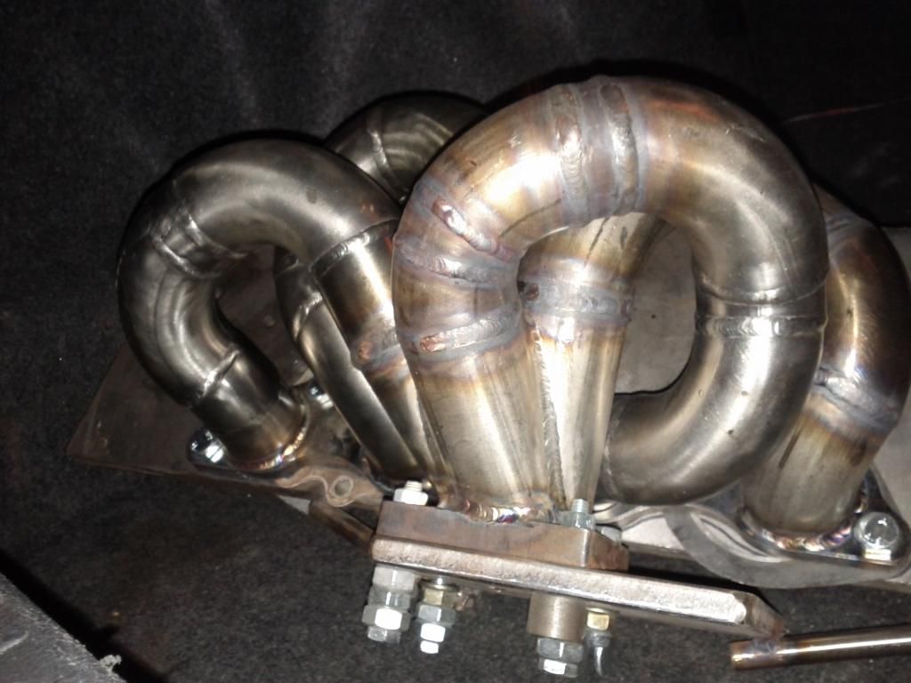

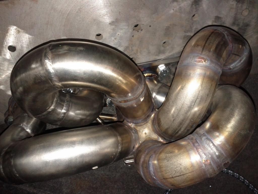

Dam that's alot of weld in the inside. Did u do two 2 passes?
I back purged mine and got bugger all inside the pipe.
RO_SUNNY
The root is around 1.5 mm on the inside....and really...that's how a root should look like.
The root is single pass with a bigger amp setting and faster movement than the capping......the root was welded at about 60 amps and then, while the weld was still hot I have welded the capping at about 35 amps.....actually the roots look like this also because I use pulse when welding SS.
I back purged mine and got bugger all inside the pipe.[/QUOTE]
This happened because you either had the gap too big....or you used high amperage settings and slow movement!
