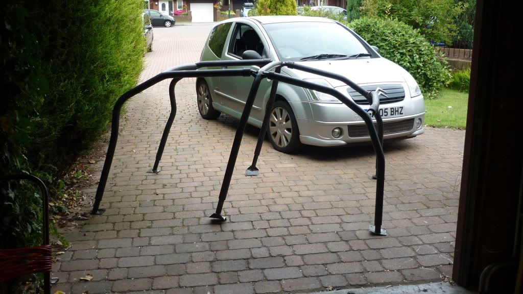

johnsy
this is very similar to the cusco cage!
I decided not to fit it in the end ,I was nt happy with bolting it in, and questioned what would actually happen in the event of an accident,I don't think there is any benefit,
i think as far as an m.o.t goes it needs to be padded where you come into contact with it
chrisyleigh
Does look a bit weak , wat about welding extra bars on it? To stiffen it up a bit more, have to think about passengers tho , hmmm some one must of done it ? Made a custom cage ? Thanks for the pic, anymore got one inside of the car?
