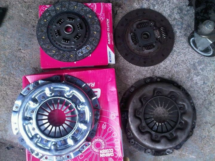

First off I'd like to thank Jim Jones for helping me out! top job by a top bloke :thumbsup:
but the route of the problem was that the spring had came out of the friction plate and had become lodged between the pressure plate and clutch plate

This is exactly what happened on my exedy clutch; mine had the four springs as yours. Ended up getting just the friction plate and it looked stronger and also had six springs. Done roughly 30,000 miles on it so far but suspect it is nearing the end of its life :sad:
Must have been the old design; the Exedy that came out of mine had four springs, and the Helix that went in has six.

Well believe it or not but the old clutch is supposedly a helix - that's according to the paperwork I got with the car
