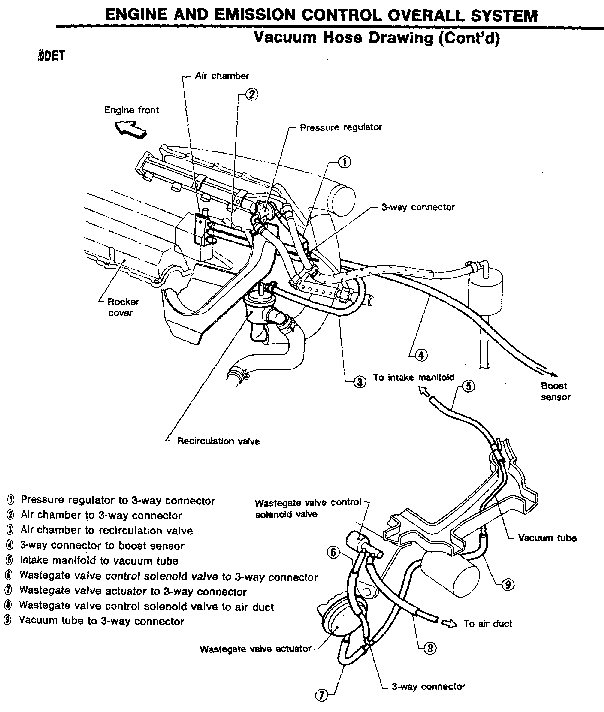

I have removed the standard boost solinoid. The boost controller i have is the Greddy Profec B. I think it is running unlimited boost as i had it up to about 1.4bar and dont want to see if it goes any higher for obvious reasons. Ive replaced all the visible vacuum hoses but still need to trace the ones infront of the bulk head. :?
geetee
stop! this controller is not ready yet :lol:
OK......
1. Is it the same with the Profec switched off?
2. Do you still have the top mount intercooler?
3. Does this make any sense to you?
If the answer to 2 was YES please ensure you have both pipes (marked 5 and 9) attached to the pipe through the intercooler frame.
If the answer to 3 is NO..... run away bravely.
If the answer to 3 is YES.... then tell us where your profec solenoid is plumbed in.
My guess is you haven't got the pipe thru the intercooler connected or you have nothing attached to the actuator.
Not 'really' a fuel cut problem..... more a "ooh I can see daylight thru my pistons question"
Let us know ;)

smcnairn
Cheers gee tee for the long and detailed reply. :wink:
1. It is the same with the Profec switched off and with the standard solinoid in place.It was overboosting before i fitted this.
2.Still go the top mount. Hoses 5 and 9 are connected.
3. YES the drawing makes! :lol:
I was thinkin it is some thing thats popped of or something is broken as when i was out one minute it was ok the next it was over boosting! :shock: Not the case of something connected up wrong.My first thought was the actuator was goosed thats why that was replaced. il have to go and have a look how the profec is plumbed in. Cant remember of the top of my head.

Right! Had a look at the boost controller and its plumbed in as per instructions. I then decided to remove my intercooler again to be sure the vacuum pipes were ok and get a proper look.......To find hose 5 crushed between the intercooler and bracket whish it bolts onto which split the hose!!! :evil: :oops: replaced the hose so the boost is back to normal... great feeling! Its now time to set up the boost controller. Thanks for the help guys :wink:
