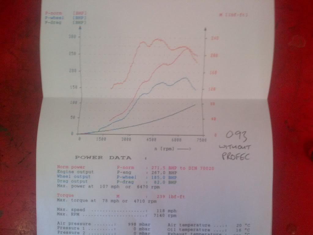

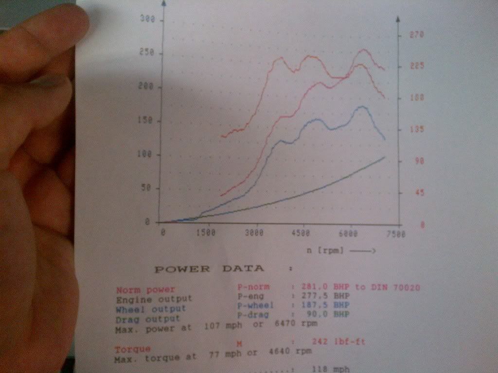

Have a look at this- Just at a dyno getting the R checked out this is the graph produced-
The guy running it says the power just drops off then comes back

have you got the afr part of chart?
it seems to me as though its an actuator problem, it maybe weak and be opening and closing, or a boost leak somewhere
temporarily pull the actuator pipe off and give it a run if your still there

Disconected the profec b and ran it through the standard solinoid and got this graph
So it looks like its not helping. Boost reached 0.93bar though (maybe because of the uprated actuator)

Like Bob said it looks like the actuators not holding pull the pipe off the actuator and see what is does.
The drag output on that dyno has varied too from 90 to 82hp.......
Did you preload the actuator when you fitted it to the turbo, the power figure is about right for a car with a standard turbo at under 1bar.

the controller must be working correctly as with it dis-connected it made 267 at stock boost yet 281 at .95
i still say either actuator fault
boost leak or a possible intermittent missfire on boost which could be why the graph is stepping off
would really need to see the afrs, that would be a big help
Have you got a wideband in the car? Don't think i'd be sticking my car on a dyno without monitoring the afr's :shock:
As Bob said they could possibly give you a big clue as to whats going on too.
You would hear a misfire that created that bloody great hole in the power curve, missfire normally occurs at peak cylinder pressure too which is usually at peak torque or about 3000rpm on this engine..... Looks more like a fuelling issue or boost issue.....mines ecu are not good anyway if you ever see the map on them it looks like a kid has taken some fuel out and added a bit of ign in his bedroom......speaking of which you could be getting lean fuelling as that is what a mines does.
Fuel pump could be a suspect too and /or the voltage to it, but you really need AFR reading to tell more
