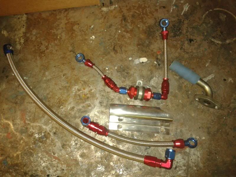

The oil drain is still the stock one but with elongated holes as its a stock fit turbo,looks fine to me,pretty much as stock.
