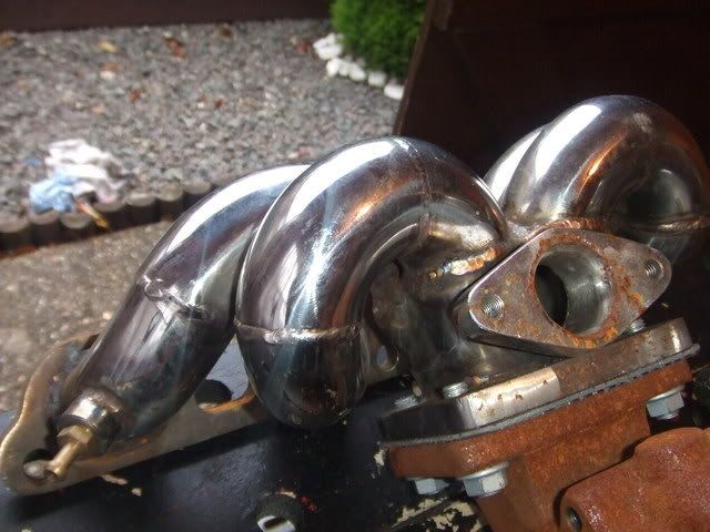

i have just bought this exhaust manifold,
has anyone got any pictures or advice of wrapping it because i want to keep the heat down because i have the front mount intercooler pipe running above it.

wrap the intercooler pipe above it for a start! you should be able to get some heat wrap/tape from your local motor parts supplier or i got mine from ebay. not rocket science here either, just wrap the intercooler pipe like a bandage.pull it tight and use something like cable ties at each end to stop it unravelling

Just make sure it fits together with an external wastegate before wasting your time wrapping it.

Also dump the wrap in a bucket of water beforehand to reduce the amount of fibres flying about when wrapping the manifold.
Once fitted it will let of some smoke and steam if still wet/damp, but that’s normal!

You'll be better off getting it ceramic coated, you'll get hot spots using heatwrap.

nah just wrap it. wouldnt be worth coating that as it just an ebay manifold from china and they are really really thin walled and crack very easily
no disrespect but its a waste of time wrapping that manifold as it will crack in no time! they are simply just not worth fitting.
port out your existing one and get that ceramic coated which will be 20 times better than fitting one of those ebay jobbies
