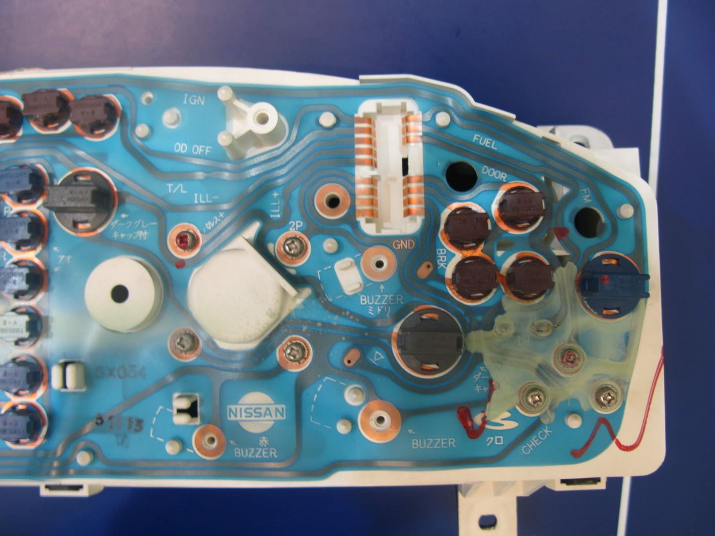

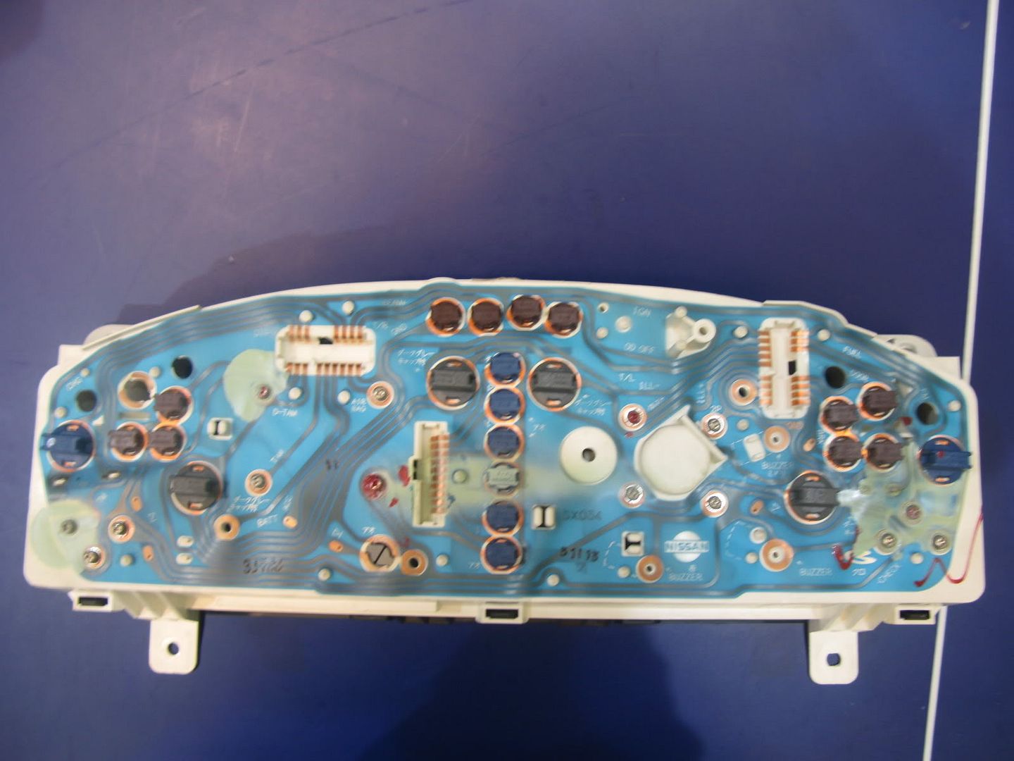

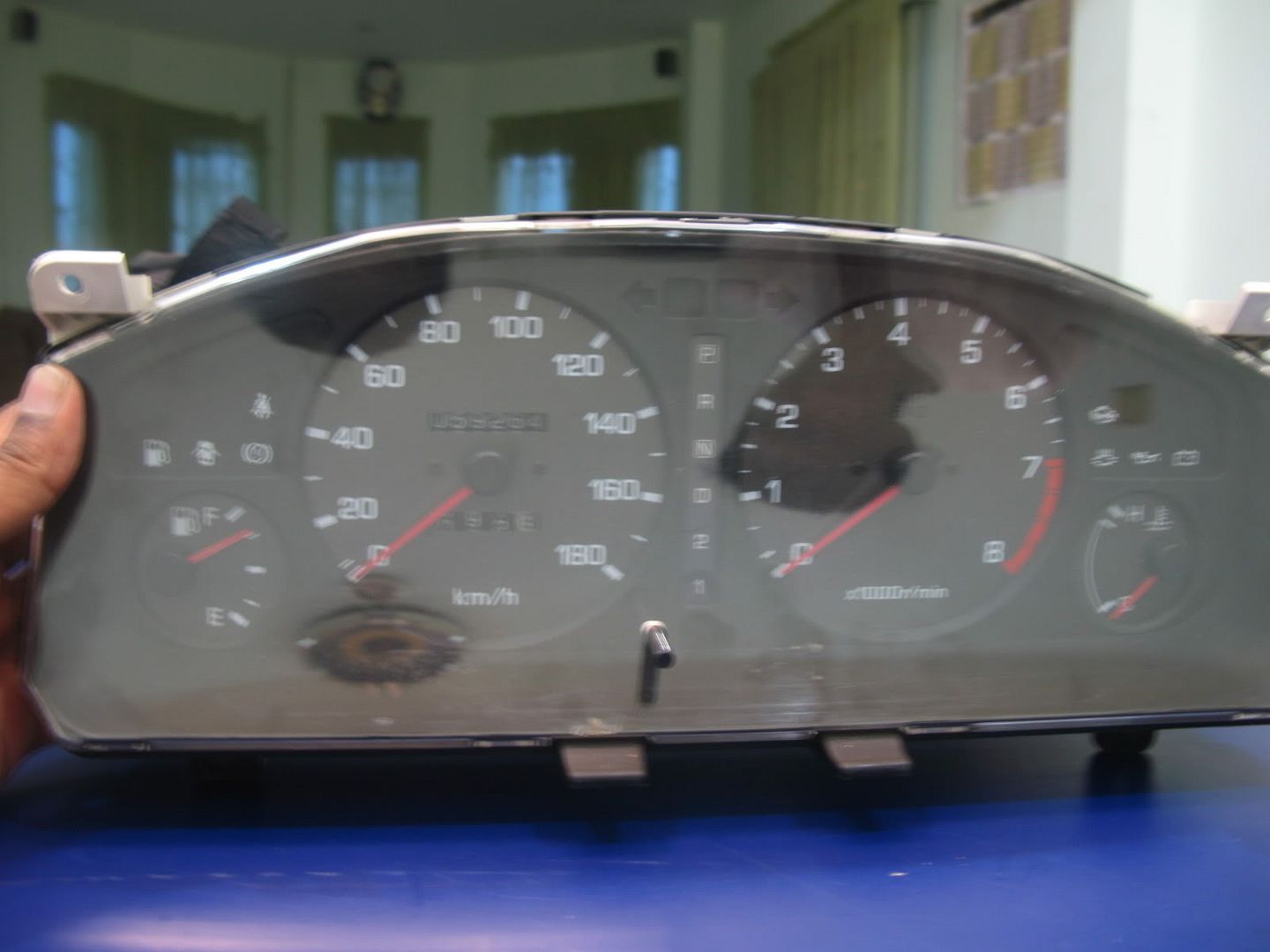

I have an Apexi AVCR hooked up to my GTi-R ecu. However, the speed wire on the ECU is not hooked up to anything. My stock (JDM) speedometer works though - so I guess it should be a straightforward hook up to some wire behind the gauge panel. Problem is - I'm not sure what I should hook into
. I attached some pics to see if it would help. I looked at the electrical part of the G20 FSM for the gauges - but this is different from my JDM panel. Any ideas?

never seen one like that in my life. its coming from an Auto gearbox?
So if i understood you right, your ECU is not getting any speed signal. From experience on normal GTiR gauges, i am thinking its one of the upper two, Either the one with 2P written or the other one with RED paint on it.

Trip - I figured it would be either of them myself...but the Jap writing has got me stumped.:der: A friend of mine who's done other transplants into Primera's says that I can just tap off from the signal wire on the speed sensor on the gear box? Looking at the wiring diagram for the N14 - it looks like that should be ok?
Trip
according to the manual the gauge Speedo uses 5 wires.. One ground (shared), One 12v (shared) and 3 other.. I am assuming that 2 are coming from the speedo sensor and the third going to ECU.. Find the odd one out :)
Get a Multi meter and trace the 2 wires coming from sensor. Trace the ground and/or the 12volts supply.. the one left should be going to ECU.
